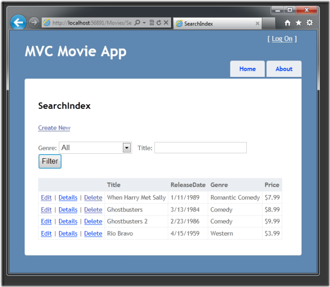

You now have a complete ASP.NET MVC application that stores data in a SQL Server Compact database. You can create, read, update, delete, and search for movies.
This basic tutorial got you started making controllers, associating them with views, and passing around hard-coded data. Then you created and designed a data model. Entity Framework Code First created a database from the data model on the fly, and the ASP.NET MVC scaffolding system automatically generated the action methods and views for basic CRUD operations. You then added a search form that let users search the database. You changed the database to include a new column of data, and then updated two pages to create and display this new data. You added validation by marking the data model with attributes from the DataAnnotations namespace. The resulting validation runs on the client and on the server.
