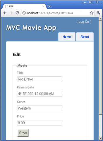

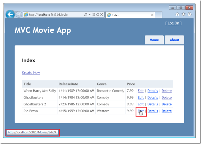

Run the application and browse to the Movies controller by appending /Movies to the URL in the address bar of your browser. Hold the mouse pointer over an Edit link to see the URL that it links to.
The Edit link was generated by the Html.ActionLink method in the Views\Movies\Index.vbhtml view:
@Html.ActionLink("Edit", "Edit", New With {.id = currentItem.ID}) |
The Html object is a helper that's exposed using a property on the WebViewPage base class. The ActionLink method of the helper makes it easy to dynamically generate HTML hyperlinks that link to action methods on controllers. The first argument to the ActionLink method is the link text to render (for example, <a>Edit Me</a>). The second argument is the name of the action method to invoke. The final argument is an anonymous object that generates the route data (in this case, the ID of 4).
The generated link shown in the previous image is http://localhost:xxxxx/Movies/Edit/4. The default route takes the URL pattern {controller}/{action}/{id}. Therefore, ASP.NET translates http://localhost:xxxxx/Movies/Edit/4 into a request to the Edit action method of the Movies controller with the parameter ID equal to 4.

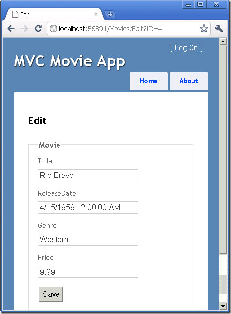

You can also pass action method parameters using a query string. For example, the URL http://localhost:xxxxx/Movies/Edit?ID=4 also passes the parameter ID of 4 to the Edit action method of the Movies controller.

Run the application and navigate to the /Movies URL. Click an Edit link. In the browser, view the source for the page. The HTML in the page looks like the following example. (The menu markup was excluded for clarity.)

The <input> elements are in an HTML <form> element whose action attribute is set to post to the /Movies/Edit URL. The form data will be posted to the server when the Edit button is clicked.

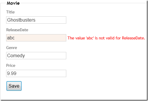

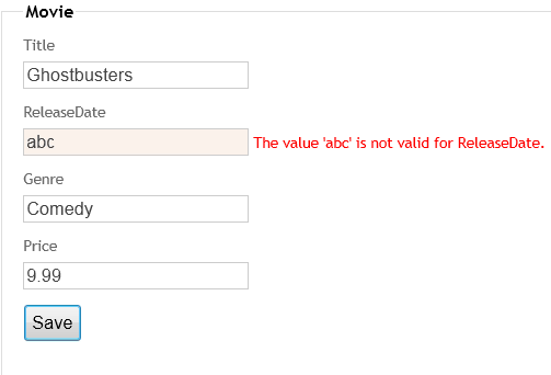

The ASP.NET framework model binder takes the posted form values and creates a Movie object that's passed as the movie parameter. The ModelState.IsValid check in the code verifies that the data submitted in the form can be used to modify a Movie object. If the data is valid, the code saves the movie data to the Movies collection of the MovieDBContext instance. The code then saves the new movie data to the database by calling the SaveChanges method of MovieDBContext, which persists changes to the database. After saving the data, the code redirects the user to the Index action method of the MoviesController class, which causes the updated movie to be displayed in the listing of movies.
If the posted values aren't valid, they are redisplayed in the form. The Html.ValidationMessageFor helpers in the Edit.vbhtml view template take care of displaying appropriate error messages.

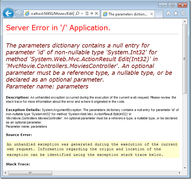

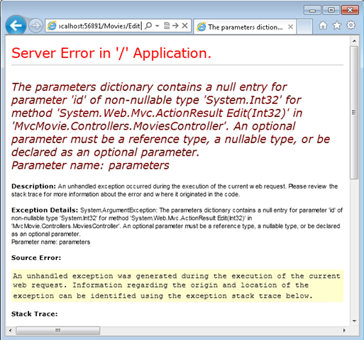

The HttpGet Edit method generated by the scaffolding system doesn't check that the ID that's passed to it is valid. If a user removes the ID segment from the URL (http://localhost:xxxxx/Movies/Edit), the following error is displayed:
A user could also pass an ID that doesn't exist in the database, such as http://localhost:xxxxx/Movies/Edit/1234. You can make two changes to the HttpGet Edit action method to address this limitation. First, change the ID parameter to have a default value of zero when an ID isn't explicitly passed. You can also check that the Find method actually found a movie before returning the movie object to the view template. The updated Edit method is shown below.
Public Function Edit(Optional ByVal id As Integer = 0) As ActionResult
    Dim movie As Movie = db.Movies.Find(id)
    If movie Is Nothing Then
        Return HttpNotFound()
    End If
    Return View(movie)
End Function
If no movie is found, the HttpNotFound method is called.

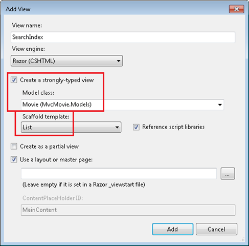

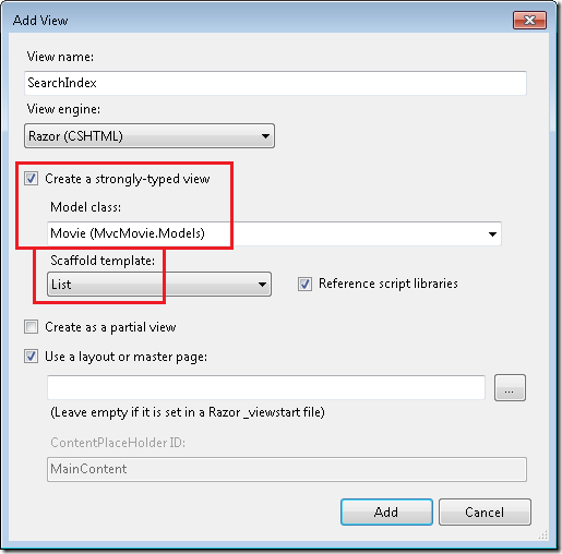

Now you can implement the SearchIndex view that will display the form to the user. Right-click inside the SearchIndex method and then click Add View. In the Add View dialog box, specify that you're going to pass a Movie object to the view template as its model class. In the Scaffold template list, choose List, then click Add.
When you click the Add button, the Views\Movies\SearchIndex.vbhtml view template is created. Because you selected List in the Scaffold template list, Visual Web Developer automatically generated (scaffolded) some default content in the view. The scaffolding created an HTML form. It examined the Movie class and created code to render <label> elements for each property of the class. The listing below shows the Create view that was generated:

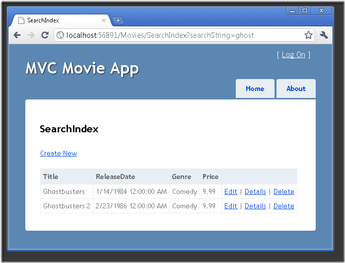

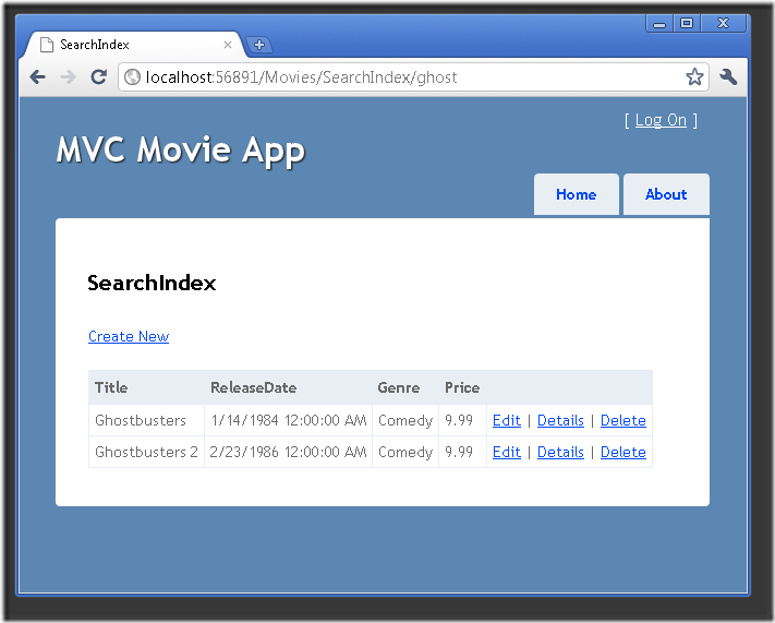

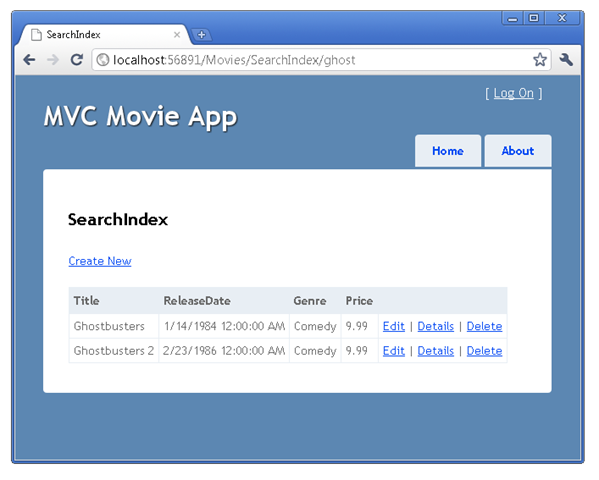

Run the application and navigate to /Movies/SearchIndex. Append a query string such as ?searchString=ghost to the URL. The filtered movies are displayed.
If you change the signature of the SearchIndex method to have a parameter named id, the id parameter will match the {id} placeholder for the default routes set in the Global.asax file.
The modified SearchIndex method would look as follows:
Public Function SearchIndex(ByVal id As String) As ActionResult
Dim searchString As String = id
Dim movies = From m In db.Movies
             Select m
If Not String.IsNullOrEmpty(searchString) Then
    movies = movies.Where(Function(s) s.Title.Contains(searchString))
End If
Return View(movies)
End Function
You can now pass the search title as route data (a URL segment) instead of as a query string value.

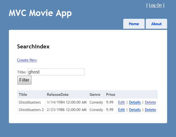

Open the Views\Movies\SearchIndex.vbhtml file, and just after @Html.ActionLink("Create New", "Create"), add the following:
@Code
    ViewData("Title") = "SearchIndex"
    Using (Html.BeginForm())
         @<p> Title: @Html.TextBox("SearchString")
         <input type="submit" value="Filter" /></p>
        End Using
End Code

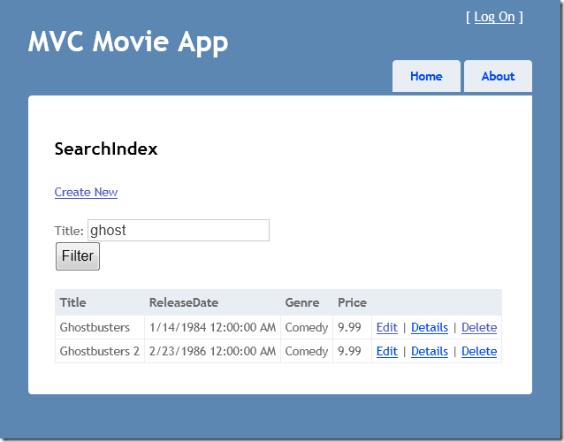

The Html.BeginForm helper creates an opening <form> tag. The Html.BeginForm helper causes the form to post to itself when the user submits the form by clicking the Filter button.
Run the application and try searching for a movie.

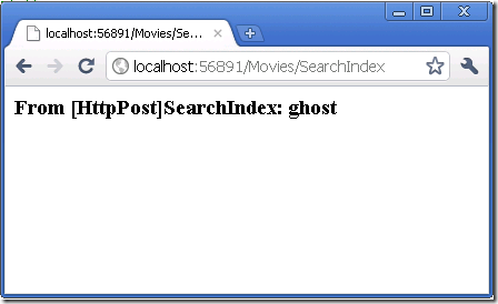

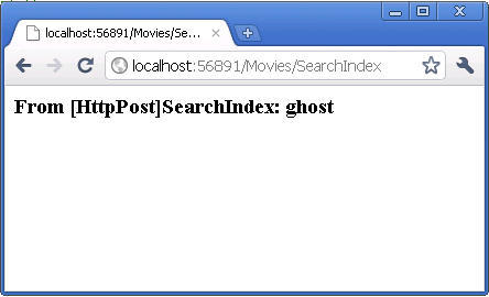

There's no HttpPost overload of the SearchIndex method. You don't need it, because the method isn't changing the state of the application, just filtering data. If you added the following HttpPost SearchIndex method, the action invoker would match the HttpPost SearchIndex method, and the HttpPost SearchIndex method would run as shown in the image below.
<HttpPost()>
 Public Function SearchIndex(ByVal fc As FormCollection, ByVal searchString As String) As String
     Return "<h3> From [HttpPost]SearchIndex: " & searchString & "</h3>"
 End Function

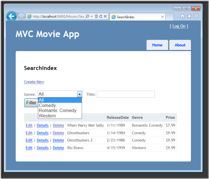

Adding Markup to the SearchIndex View to Support Search by Genre
Add an Html.DropDownList helper to the Views\Movies\SearchIndex.vbhtml file, just before the TextBox helper. The completed markup is shown below:
<p>
    @Code
         @<p> Genre: @Html.DropDownList("movieGenre", "All")
        End Using
End Code
</p>
Run the application and browse to /Movies/SearchIndex. Try a search by genre, by movie name, and by both criteria.
In this section you examined the CRUD action methods and views generated by the framework. You created a search action method and view that let users search by movie title and genre. In the next section, you'll look at how to add a property to the Movie model and how to add an initializer that will automatically create a test database.
