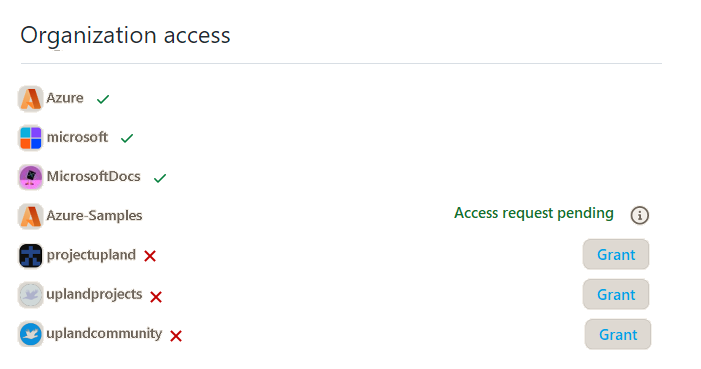

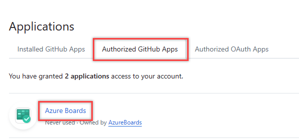

From the GitHub web portal, open Settings from your profile menu.
Select Applications under Integrations.
Select Authorized GitHub Apps > Azure Boards.
Under Organization access, resolve any issues that might appear. Select Grant to grant access to any organizations that show as having an Access request pending.

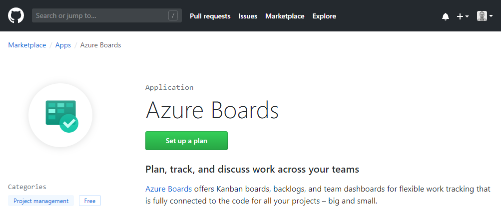

Go to the Azure Boards app in the GitHub Marketplace.
Select Set up a plan.

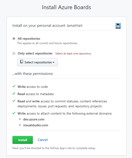

Choose the repositories that you want to connect to Azure Boards.
In the following example, we choose to connect to all repositories.

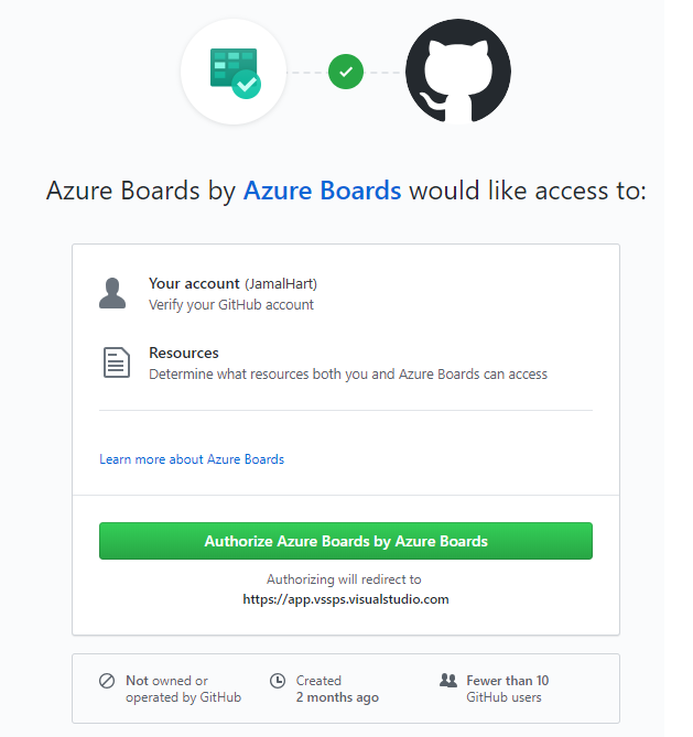

To connect with GitHub.com, authorize your Azure Boards organization.

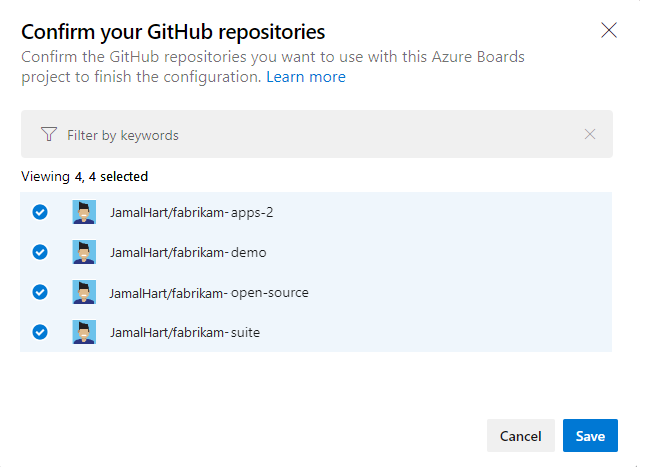

Confirm the GitHub.com repositories that you want to connect. Select each repository you want to connect to. Unselect any repositories that you don't want to participate in the integration.

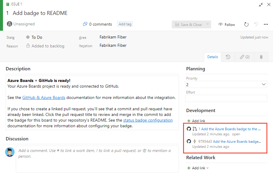

On your board, select New work item to enter a new work item named "Add badge to README"—Issue (Basic), User Story (Agile), or Product Backlog Item (Scrum)—depending on the process model used by your Azure Boards project.
A work item titled Add badge to README appears on your board.

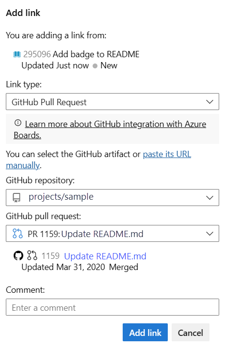

Open your work item, go to the Development section, and select Add link.
Select GitHub Pull Request from the Link type dropdown menu.
Select the repository and enter the pull request ID and an optional comment.
Select Add link.
The following actions occur in the background, automatically:
- Adds a badge to the README file of the first repository in the list of connected GitHub repositories.
- Creates a GitHub commit for the update made by adding the badge to the README file.
- Creates a GitHub pull request to merge the changes made to the README file.
- Links the GitHub commit and pull request to the work item created in step 1.

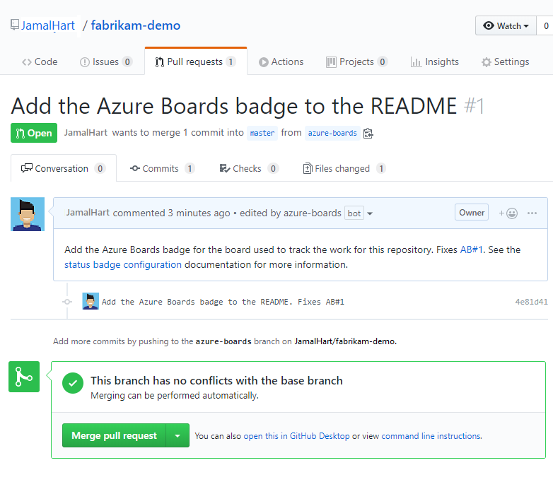

Select the first pull request link from your work item.
The GitHub pull request opens in a new browser tab.

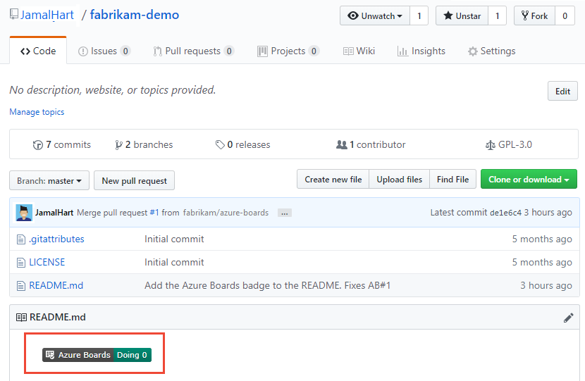

Select Merge pull request.
Go to your repository README file and view the badge that was added.
For more information, see Configure status badges to add to GitHub README files.

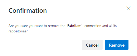

actions icon for the connection and choose Add repositories or Remove repositories from the menu.
To remove all repositories and the connection, choose the Remove connection option. Then, choose Remove to confirm.

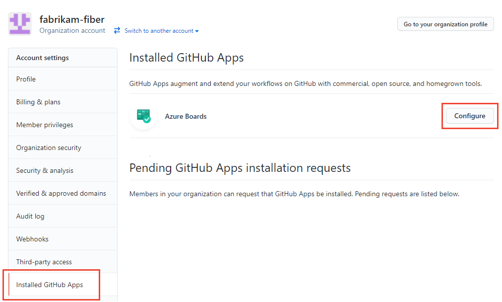

Sign into GitHub and open your organization profile settings.
https://github.com/organizations/fabrikam-fiber/settings/profileGo to Installed GitHub Apps > Azure Boards > Configure.
The Azure Boards configuration page opens.

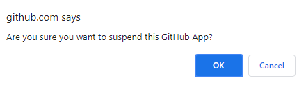

Suspend or uninstall Azure Boards integration
Starting from step 2 in the previous procedure, scroll down to the Danger zone section.
To suspend the integration, choose Suspend. From the popup confirmation window, choose OK to confirm the suspension.
To unsuspend the integration, choose Unsuspend.

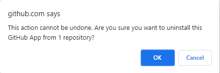

To uninstall the Azure Boards app, choose Uninstall, and then choose OK from the popup confirmation window.

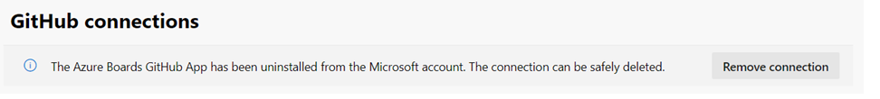

If you uninstall the Azure Boards app for GitHub, the following message displays in Azure Boards, Project settings > GitHub connections. Choose Remove connection to remove all previously made GitHub connections. For more information, see Add/remove GitHub repositories.
