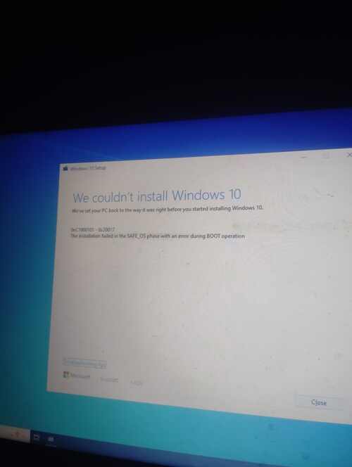

“The installation failed in the SAFE_OS phase with an error during BOOT operation.”
0xC1900101 - 0x20017
someone please help me as i am facing this issue from last 10 days. whenever i try to reinstall windows or reset my pc , black screen appears during booting and all the process end there.

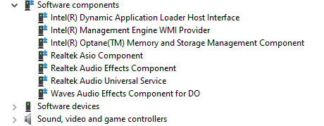

2025-11-01T15:43:55.45+00:00 brother did you mean these drivers i had to install
Ramesh Srinivasan • 172.4K Reputation points • Volunteer Moderator2025-11-01T15:47:19.2766667+00:00 Yes, can you post that link here?

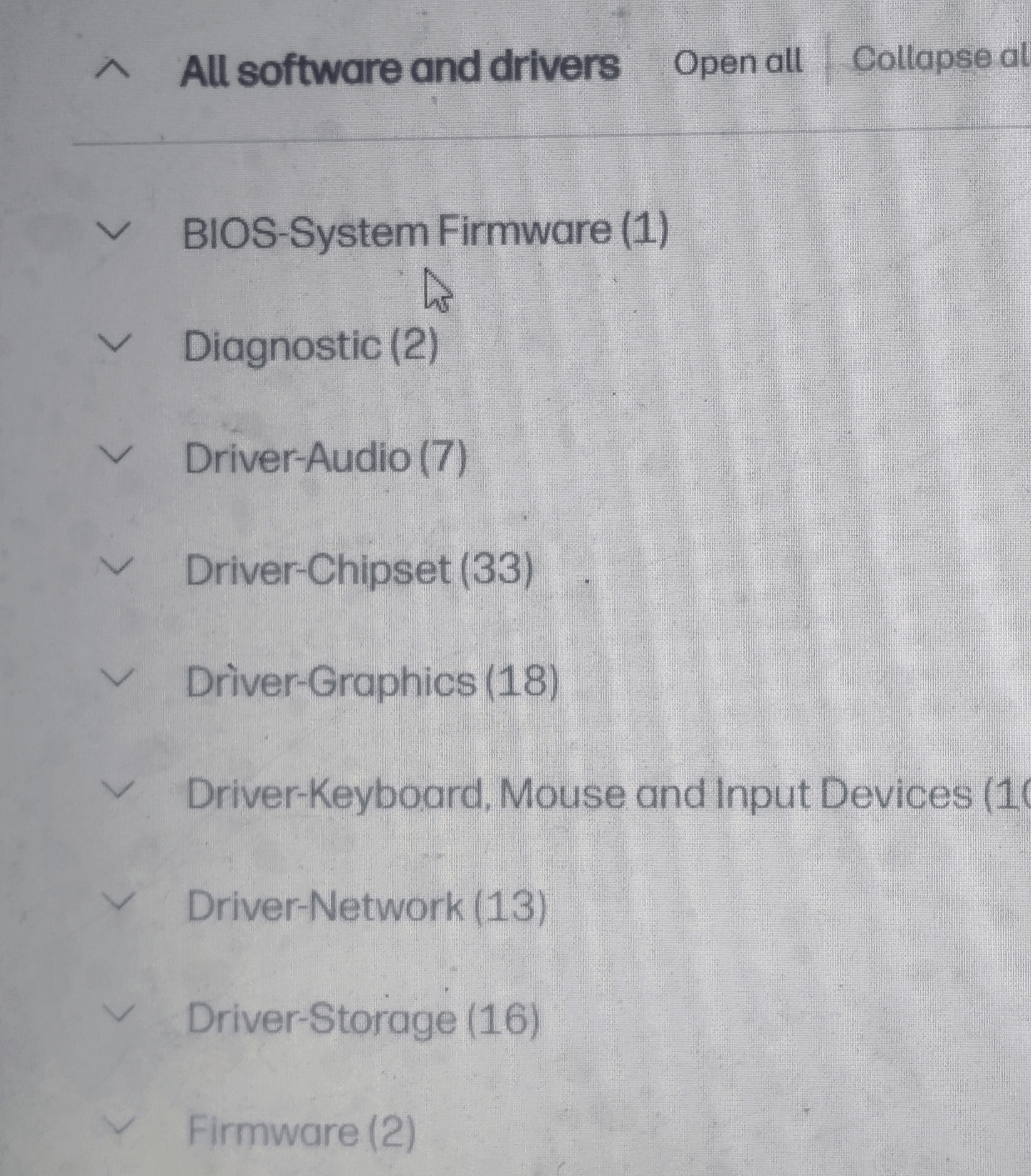

2025-11-01T16:03:39.8566667+00:00 -
Zakir Najar • 0 Reputation points
2025-11-01T16:05:03.2+00:00 i am using windows 10 2h22 but when i choose operating system there is not showing this version then i select windows 10 64
Ramesh Srinivasan • 172.4K Reputation points • Volunteer Moderator2025-11-01T16:07:28.51+00:00 The following one seems to be latest on HP's site.
- Intel Rapid Storage Technology Driver
- 17.5.2.1024 Rev.A
- 22.0 MB
- Dec 27, 2019
Also, update the LAN drivers if available.

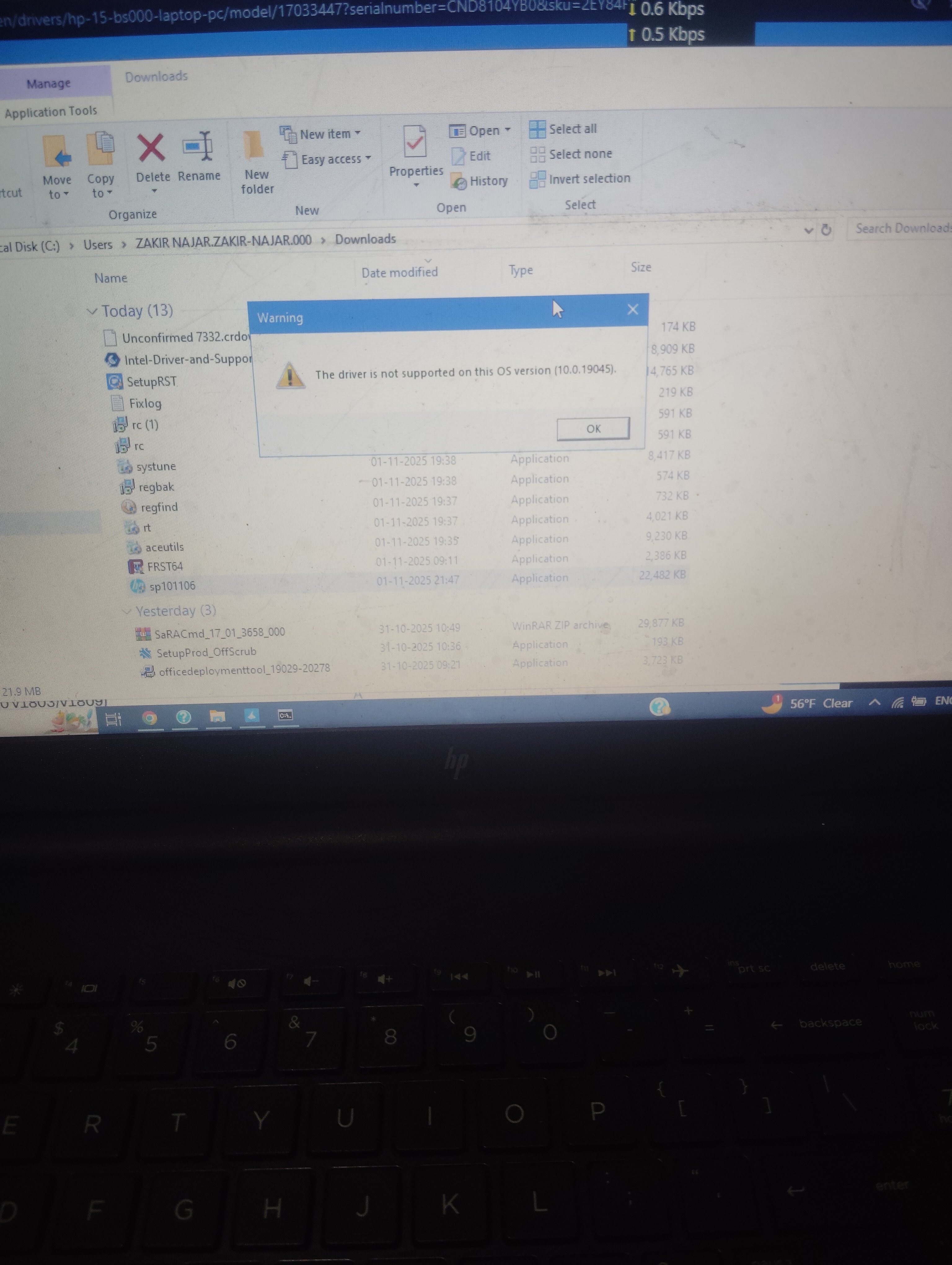

2025-11-01T16:15:34.5733333+00:00 cant find any lan driver or the above rst driver you mentioned
2025-11-01T16:17:42.46+00:00 i downloaded the rst driver
2025-11-01T16:19:29.3633333+00:00 it shows the driver is not supported on this os version 10.0.19045
Ramesh Srinivasan • 172.4K Reputation points • Volunteer Moderator2025-11-01T16:19:35.6566667+00:00 After downloading it, install it.
2025-11-01T16:20:29.3966667+00:00 it shows the driver is not supported on this os version 10.0.19045
Sign in to comment -
Ramesh Srinivasan • 172.4K Reputation points • Volunteer Moderator2025-11-01T16:25:35.27+00:00 Open Device Manager and expand "Software Components".
Post a screenshot.

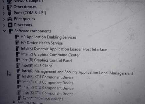

Uninstall each
Intel XTU Component Devicelisted. Select "Delete the driver software for this device" when prompted. -

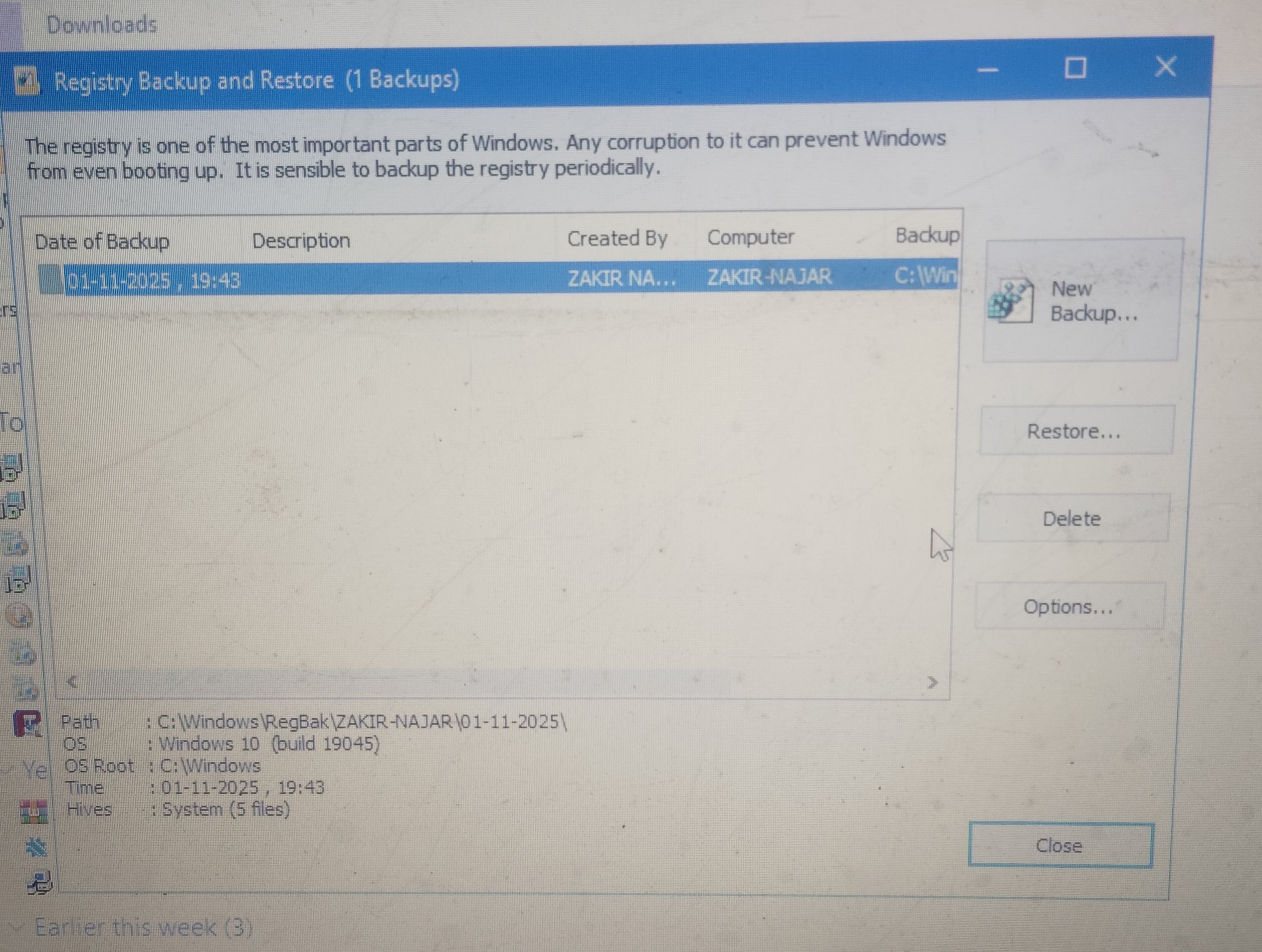

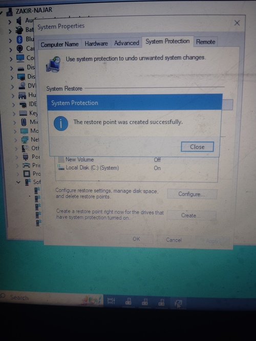

2025-11-01T16:36:51.14+00:00 how to create a system restore point
Ramesh Srinivasan • 172.4K Reputation points • Volunteer Moderator2025-11-01T16:37:49.0666667+00:00 To create a restore point in Windows 10, search for "Create a restore point," open it, click "Create" under the "System Protection" tab, type a descriptive name for the point, and click "Create" again
2025-11-01T16:45:48.85+00:00 -
Richie99-3 • 0 Reputation points
2025-11-01T16:48:33.9233333+00:00 Do you have a driver saying HP, my driver is Dell
Ramesh Srinivasan • 172.4K Reputation points • Volunteer Moderator2025-11-01T16:49:16.05+00:00 Please try the repair installation now and let me know how it went.
If the setup fails again, we can remove the next set of driviers.

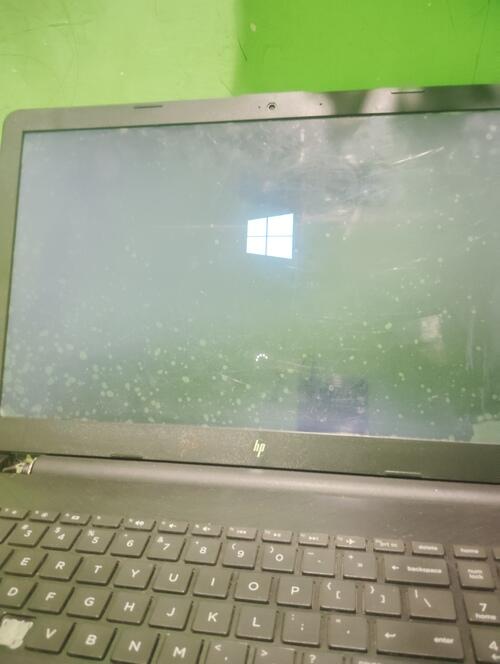

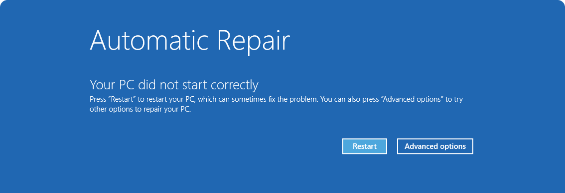

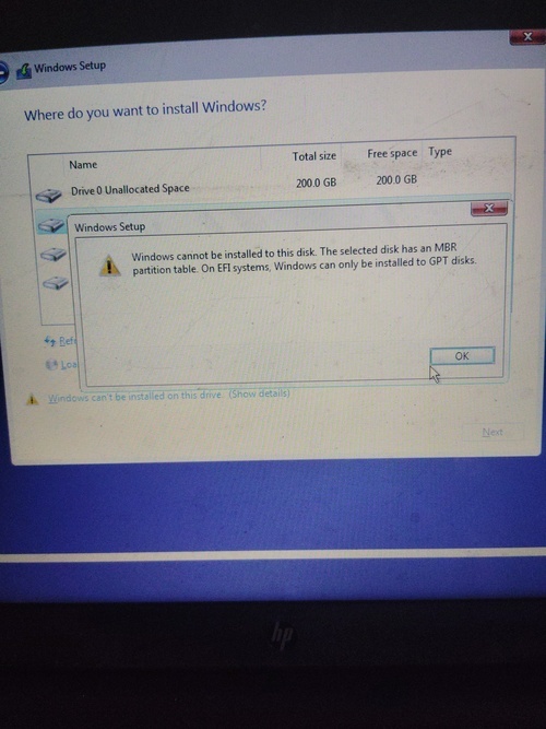

2025-11-01T16:53:41.73+00:00 can i try to reinstall windows to check black screen and the error of boot operation have gome away
Ramesh Srinivasan • 172.4K Reputation points • Volunteer Moderator2025-11-01T16:54:44.6+00:00 Ok. Please try the repair installation now and let me know how it goes.
If the setup fails again, we can remove the next set of drivers.
2025-11-01T16:56:19+00:00 ok sir wait it will take some time.
2025-11-01T17:38:45.81+00:00 same error black screen again appeared during restarting ...now i will forcebly hold on power key it will power off. if i open it again it will shows the same error like boot operation failed
Ramesh Srinivasan • 172.4K Reputation points • Volunteer Moderator2025-11-01T17:39:34.93+00:00 Was there an error code after the setup failed?

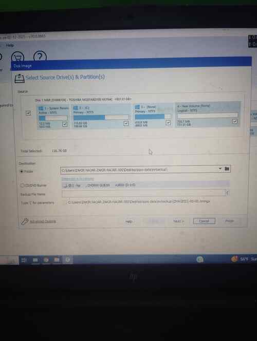

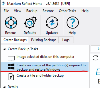

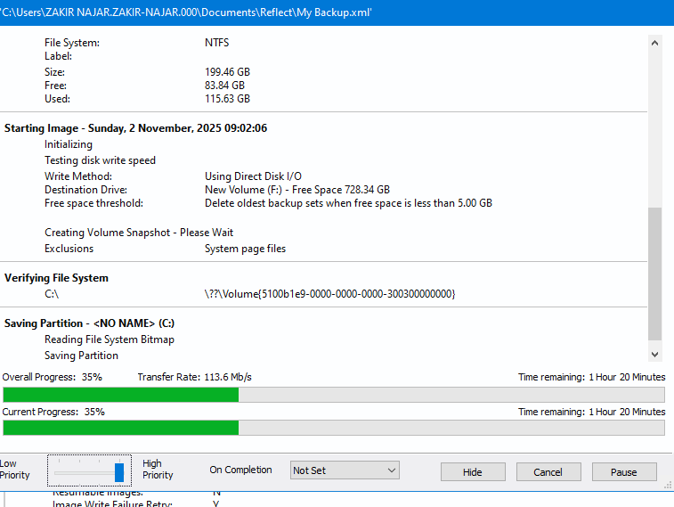

2025-11-02T03:24:34.57+00:00 which part i have to backup and where i should make a folder to backup
Ramesh Srinivasan • 172.4K Reputation points • Volunteer Moderator2025-11-02T03:36:21.57+00:00 Not sure why you're taking screenshots using the phone instead of the built-in options?
Choose the option in the following screenshot.
Save the OS image in an external drive.
2025-11-02T03:41:44.37+00:00 sir is this backup necessary or we can proceed without this
Ramesh Srinivasan • 172.4K Reputation points • Volunteer Moderator2025-11-02T03:52:22.2466667+00:00 It's necessary that that's why I suggested it.
2025-11-02T04:16:10.9033333+00:00 -
2025-11-02T04:37:23.88+00:00 back up done sir
Ramesh Srinivasan • 172.4K Reputation points • Volunteer Moderator2025-11-02T04:41:35.1966667+00:00 Create a System Restore Point.

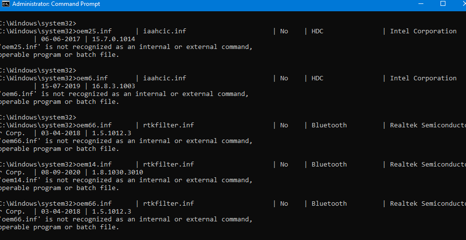

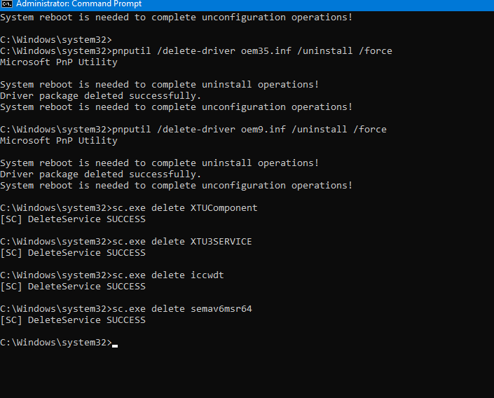

From admin Command Prompt, run:
pnputil /delete-driver oem82.inf /uninstall /force pnputil /delete-driver oem83.inf /uninstall /force pnputil /delete-driver oem84.inf /uninstall /force pnputil /delete-driver oem45.inf /uninstall /force pnputil /delete-driver oem35.inf /uninstall /force pnputil /delete-driver oem9.inf /uninstall /force sc.exe delete XTUComponent sc.exe delete XTU3SERVICE sc.exe delete iccwdt sc.exe delete semav6msr64Post the output.
2025-11-02T04:49:01.3033333+00:00 -
Ramesh Srinivasan • 172.4K Reputation points • Volunteer Moderator2025-11-02T04:50:33.33+00:00 Restart Windows.
2025-11-02T04:55:44.0266667+00:00 done next
Ramesh Srinivasan • 172.4K Reputation points • Volunteer Moderator2025-11-02T04:58:43.93+00:00 Unplug all peripherals except the keyboard and mouse. Then, run these two commands:
rundll32.exe pnpclean.dll,RunDLL_PnpClean /DEVICES /DRIVERS /MAXCLEAN DISM /online /get-drivers /format:tablePost the output.

Also, did the 1st command show any output?
2025-11-02T05:09:15.5866667+00:00 ist command did not show any output
Ramesh Srinivasan • 172.4K Reputation points • Volunteer Moderator2025-11-02T05:10:29.8+00:00 Run:

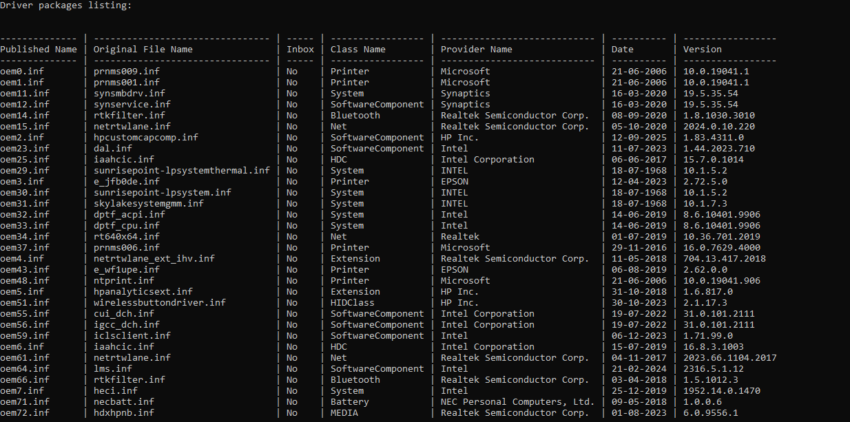

pnputil /delete-driver oem14.inf /uninstall /force pnputil /delete-driver oem66.inf /uninstall /forceRerun the Windows 10 setup. Let me know how it goes. If the same error occurs, we'll try removing
iastorac.sys. -
2025-11-02T11:57:53.7+00:00 same error brother
Ramesh Srinivasan • 172.4K Reputation points • Volunteer Moderator2025-11-02T12:16:19.01+00:00 Next, we can remove the following drivers.
oem14.inf | rtkfilter.inf | No | Bluetooth | Realtek Semiconductor Corp. | 08-09-2020 | 1.8.1030.3010 oem25.inf | iaahcic.inf | No | HDC | Intel Corporation | 06-06-2017 | 15.7.0.1014 oem6.inf | iaahcic.inf | No | HDC | Intel Corporation | 15-07-2019 | 16.8.3.1003 oem66.inf | rtkfilter.inf | No | Bluetooth | Realtek Semiconductor Corp. | 03-04-2018 | 1.5.1012.3However, note that uninstalling the HDC driver can sometimes be a risky process. If something goes wrong during the process, you can restore the Macrium image backup using the Macrium rescue media.

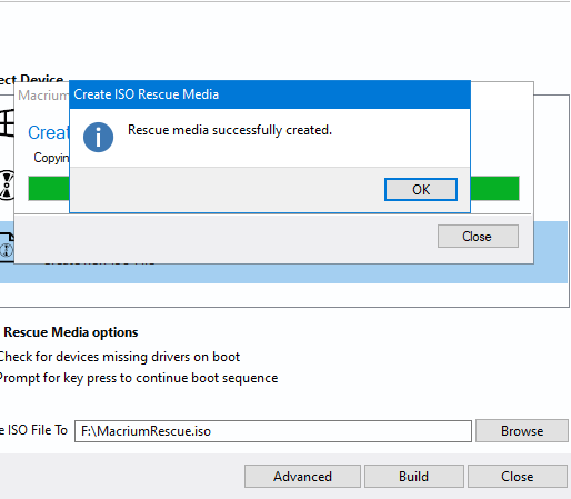

Will post the commands after you create the rescue media. Creating Rescue Media
2025-11-02T13:04:09.79+00:00 where i can remove these drivers
Ramesh Srinivasan • 172.4K Reputation points • Volunteer Moderator2025-11-02T13:04:43.9233333+00:00 Will post the commands after you create the rescue media. Creating Rescue Media
2025-11-02T13:06:34.18+00:00 how to remove these drivers
Ramesh Srinivasan • 172.4K Reputation points • Volunteer Moderator2025-11-02T13:07:58.27+00:00 See Creating Rescue Media first
2025-11-02T13:10:20.7933333+00:00 i opened this creating rescue media. next
Ramesh Srinivasan • 172.4K Reputation points • Volunteer Moderator2025-11-02T13:11:31.1233333+00:00 Let me know after you create the rescue media.
Ramesh Srinivasan • 172.4K Reputation points • Volunteer Moderator2025-11-02T13:24:40.29+00:00 One done, use DDU to completely uninstall the graphics drivers. We have backed up the driver package already, so that shouldn't be an issue.

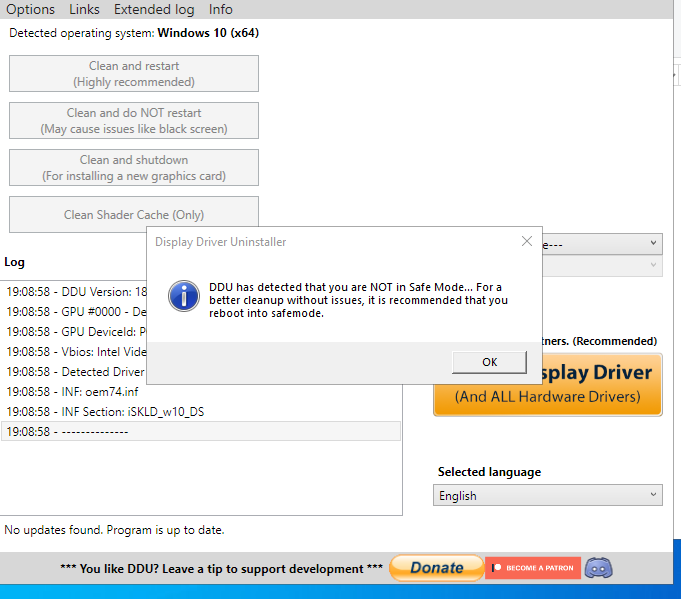

Display Driver Uninstaller (DDU) download version 18.1.3.8
Retry the 22H2 repair installation.
If it still fails, we'll remove the four drivers I mentioned in my previous post.

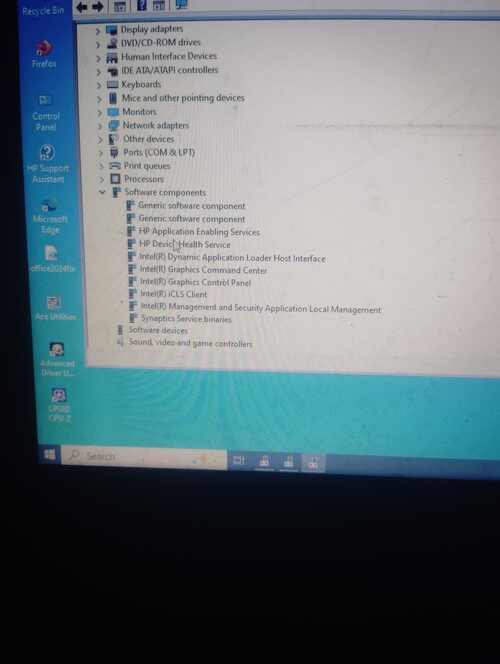

2025-11-02T13:34:49.2366667+00:00 -
2025-11-02T13:35:29.1033333+00:00 there is no option of uninstall
2025-11-02T13:40:07.3566667+00:00 -
2025-11-02T14:07:16.0166667+00:00 brother i have attached screenshot. how to uninstall now
2025-11-02T14:45:07.43+00:00 after uninstalliny 5he graphic driver it has been restarted and this window logo stuck .... it is not working now from here
Ramesh Srinivasan • 172.4K Reputation points • Volunteer Moderator2025-11-02T14:53:43.1666667+00:00 - Start your device and wait for the Windows logo (or the manufacturer's logo) to appear
- As soon as the Windows logo appears, press and hold the power button until the device shuts down
- Turn your device on again and repeat step 2
- Turn your device on a third time. Windows should display the Automatic Repair screen
- Select Advanced options
In Windows RE, use "Startup Repair".
https://support.microsoft.com/en-us/windows/startup-repair-85deb0b9-fa3d-44a3-a3d0-d0f1515c2c9b
If Startup Repair can't identify the problem, boot into Safe mode.
2025-11-02T15:04:48.56+00:00 brother when window logo appears the black screen appears at the same time.. i tried many times to login but not able to as it goes black screen
Ramesh Srinivasan • 172.4K Reputation points • Volunteer Moderator2025-11-02T15:06:11.8466667+00:00 Have you tried Startup Repair?
Ramesh Srinivasan • 172.4K Reputation points • Volunteer Moderator2025-11-02T15:07:29.2833333+00:00 Also. try Safe mode?
2025-11-02T15:08:30.2566667+00:00 i followed the steps you told me to do but start up repair did not showed there
2025-11-02T15:10:54.7533333+00:00 only black screen appeared now

Ramesh Srinivasan • 172.4K Reputation points • Volunteer Moderator2025-11-02T15:25:17.4166667+00:00 You should be able to boot from the Macrium Rescue media and restore the OS image you backed up yesterday.
But I wonder why it's not booting after unisntalling the display drivers. The Microsoft Standard video drivers are supposed to load.
Ramesh Srinivasan • 172.4K Reputation points • Volunteer Moderator2025-11-02T15:27:18.86+00:00 If you wish to do a clean install, you can create a Windows 10 USB setup disk and boot from it. The data can be recovered from WinRE before beginning the clean install.

Yes, that's the recommended method for creating the USB setup disk.
After creating the disk, boot from it. You may need to change the boot order in the BIOS or the one-time boot menu.

Ramesh Srinivasan • 172.4K Reputation points • Volunteer Moderator2025-11-02T15:48:39.4866667+00:00 Ok. You can also try another option.
Boot from the Macrium rescue media and restore the OS image you backed up earlier today.
After booting into Windows, reinstall Windows 10 with the "Keep nothing" option.

Windows Setup: Installing using the MBR or GPT partition style | Microsoft Learn

Ryan Cole Mr • 5 Reputation points
2025-11-02T06:45:06.6133333+00:00 That specific error (0xC1900101 – 0x20017) almost always points to a driver or firmware issue that stops Windows from rebooting into the next setup stage. The black screen during the reboot is a big clue.
A few things you can try that usually fix this:
- Disconnect everything you can. Unplug USB drives, external HDDs, printers, adapters, etc. A bad USB/driver can stop the SAFE_OS boot.
- Update BIOS/UEFI. If your BIOS is outdated, Windows setup can fail at exactly this step. Check your motherboard/laptop manufacturer’s website for the latest version.
- Remove or disable third-party drivers. If you have things like old VPN drivers, antivirus, RGB software, or leftover GPU drivers, uninstall them. In BIOS, temporarily disable things like:
Fast Boot
Secure Boot (you can re-enable later)
CSM/Legacy Mode (set to UEFI only)
- Try installing with only one stick of RAM. It sounds odd, but faulty or mismatched RAM can trigger this error during the SAFE_OS phase.
- Recreate your installation media. Use the official Media Creation Tool to make a fresh USB. Corrupted install media can cause the exact black-screen behavior you described.
- If the PC blacks out even on Reset This PC. Boot into Advanced Startup → Command Prompt and try:
sfc /scannow DISM /online /cleanup-image /restorehealthThis sometimes fixes the boot files enough for the installer to continue.
If you can share your exact PC model and whether the black screen has a cursor or stays fully blank, it’ll be easier to pinpoint what’s blocking the install.

DYARI BARHAM • 29,066 Reputation points • Independent Advisor
2025-11-02T15:15:48.71+00:00 Based on the FRST file, I have noticed that you have installed KMSpico. If it is still available, please uninstall it. If you installed third-party antivirus software, uninstall it too. Have you tried performing a clean install instead of upgrading it?
Note: Back up your important files if any.
