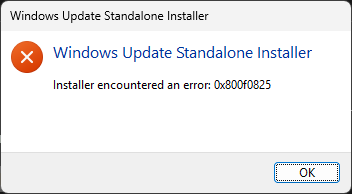

I can't uninstall kb:5065789 - I get 'Installer encountered an error: 0x800f0825'. So I'm stuck with no IIS for the moment. Happy to try any other suggestions anyone might have
Having this error while trying to uninstall
I had the same error trying to uninstall kb:5066835 -- remove Windows Sandbox from Windows features first (takes an eternity; be patient). Then perform the uninstall. Worked for me. IIS/localhost working again. Then put Windows Update on pause for a few weeks, to give MS time to resolve. Good luck.
Mine Sandbox is not installed and still getting same error.
Check this file (%windir%\logs\cbs\CBS.log) for error 0x800f0825. Just before the error in the file, in my case, there was an error relating to HyperV. So I removed that feature temporarily from Turn Windows Features On and Off, and then I could uninstall KB5065789 successfully and IIS is working correctly again.

I cannot uninstall KB5066835, fails with error: 0x800F0825
See if you have Sandbox feature enabled. If so, turn off, and now you should be able to uninstall the update
I have this issue. Haven't got sandbox enabled. And I'm unable to install KB5065789 due to error 0x800F0825. KB5066835 did uninstall for me, but I still have the same issue with IIS. I've tried all the other suggestions I can find, but can't get it working!
About an error 0x800F0825, open %windir%\logs\cbs\CBS.log and search for 0x800F0825 from the end, it should give you an hint on the error origin.
In one case we had to deactivate "wmic" and "print control management" before being able to uninstall the KB6066835 (we reactivated the two features afterward).

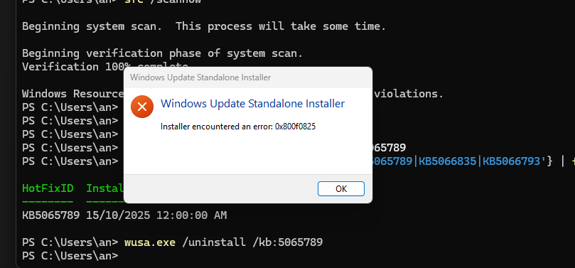

So what do you do when you encounter the error in the screenshot? Like I have? There isn't any way to uninstall both for many!!
I also issued a net stop was as administrator before the uninstall which should take down IIS if its started but not running. It could be that one of its loaded dependencies is what is causing the uninstall to fail.
Check this file (%windir%\logs\cbs\CBS.log) for the error you get when uninstalling KB5065789. Just before the error in the file, in my case, there was an error relating to HyperV. So I removed that feature temporarily from Turn Windows Features On and Off, and then I could uninstall KB5065789 successfully and IIS is working correctly again.
