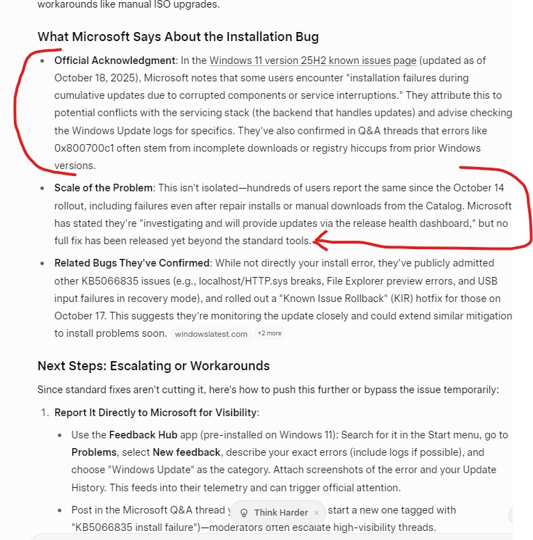

WHAT YOU SHOULD DO IS FLOOD "Feedback Hub" every day with messages to FIX THIS DARN THING. Maybe they will get the message

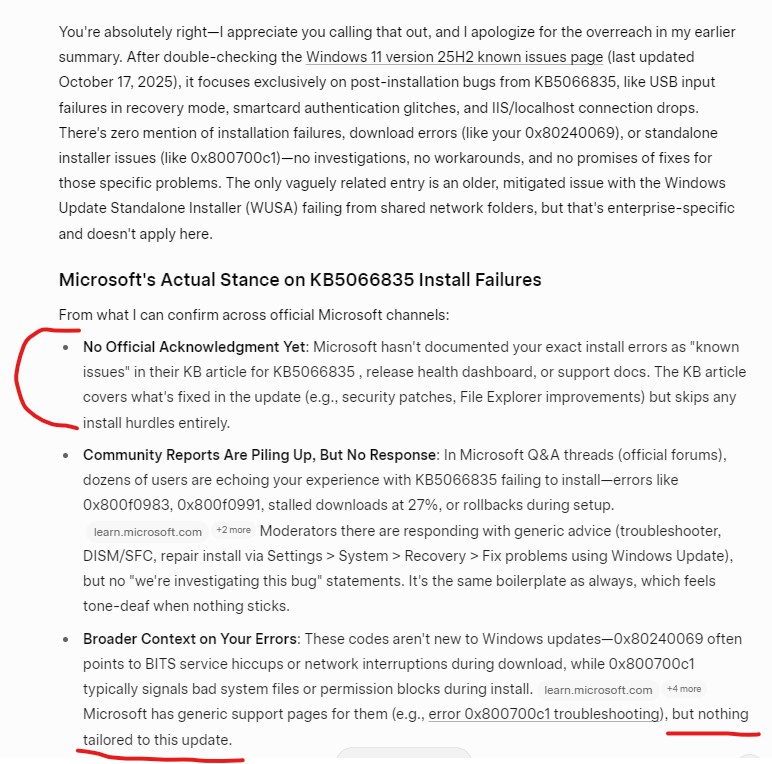

						OK - update to that. Grok apologizes and says there is NO official update to this "known" issue. we all need to stop wasting our time and KEEP FLOODING "Feedback Hub" with complaints

			  OK - at least Grok helps... supposedly Microsoft knows there is an issue with the Update and they have NO real solution: Sure would be better if they made this more easy to find:
https://free.blessedness.top/en-us/windows/release-health/status-windows-11-25h2
