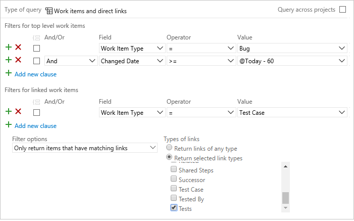

List bugs and the test cases that test them
Open a new query, set the query type to Work items and direct links. Filter for bugs in the top level and add the filter for Test Cases in the linked work items filter.
You can't construct a query that shows a hierarchical view of Test Plans, Test Suites, and Test Cases. These items aren't linked together using parent-child link types. You can view the hierarchy through the Test>Test Plans page.
