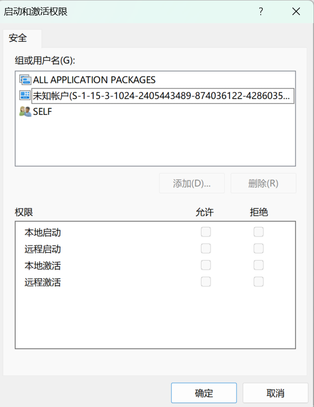

  1. COM Server Permission Error: Application-specific permission settings do not grant Local Activation permission for the COM Server application with CLSID {2593F8B9-4EAF-457C-B68A-50F6B8EA6B54} and APPID {15C20B67-12E7-4BB6-92BB-7AFF07997402} to the user myzhao\my zhao SID (S-1-5-21-3192212609-1034257735-2234904885-1002) running from the application container Unavailable SID (Unavailable).

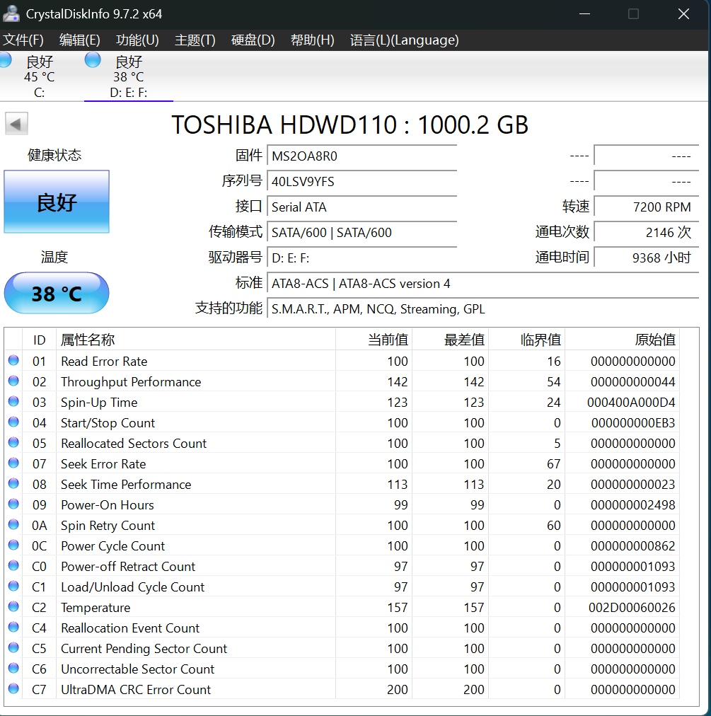

    • Model: TOSHIBA HDWD110
    • Serial Number: 40LSV9YFS
    • Bus Type: SATA

    2. Check SMART health:
         wmic diskdrive get status, model
      → If it reports anything other than OK, back up data immediately.
    3. Update SATA/Chipset/Storage drivers from your motherboard or OEM website — do not rely on Windows Update drivers for this case.
    If issues persist, test the drive on another system to rule out hardware failure.
    2. COM Server Permission Error
    The CLSID {2593F8B9-4EAF-457C-B68A-50F6B8EA6B54} corresponds to the RuntimeBroker service. This can appear after upgrades when DCOM permissions reset or user accounts lose local activation rights.
    To fix:
    1. Open Component Servicesdcomcnfg.
    2. Navigate to: Component Services → Computers → My Computer → DCOM Config → RuntimeBroker
    3. Right-click → Properties → Security tab
    4. Under Launch and Activation Permissions, choose Edit → Add your user (e.g., myzhao) → grant Local Activation.

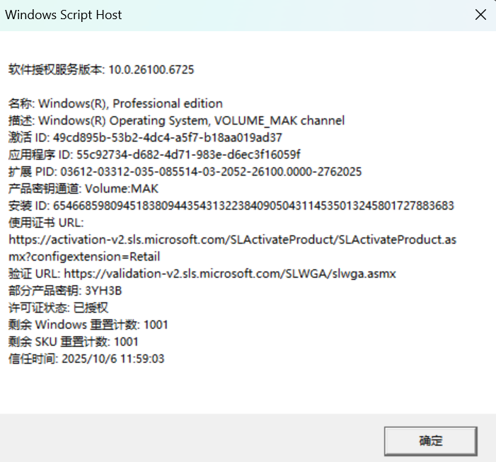

    If you can share the output of:
    chkdsk D:
    and
    slmgr /dlv
    we can narrow down whether this is a failing drive or a software corruption chain.
