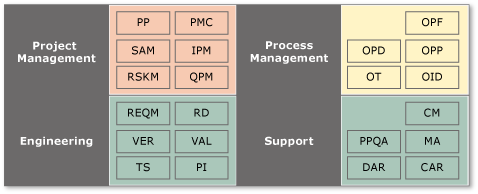

The Continuous Representation models process capability within each of the 22 process areas individually, which allows the organization to tailor their improvement efforts to the processes that offer the highest business value. This representation is more in line with Crosby's original model. Appraisals against this model result in profiles of capability rather than a single number. Because the organizational maturity level is the level that most managers and executives understand, there are ways of mapping the results of a continuous model assessment into the five stages.

In the Continuous Representation, the process areas are mapped into functional groupings, as shown in the following illustration.
Each process area is made up of required, expected, and informative components. Only the required components are actually required to satisfy an appraisal against the model. The required components are the specific and generic goals for each process area. The expected components are the specific and generic practices for each specific or generic goal. Note that, because an expected component is merely expected and not required, this indicates that a specific or generic practice can be replaced by an equivalent practice. The expected practices are there to guide implementers and appraisers. If an alternative practice is chosen, it's up to the implementer to advise an appraiser and justify why an alternative practice is appropriate. Informative components provide details that help implementers get started with a process improvement initiative that is guided by the CMMI model. Informative components include subpractices of generic and specific practices and typical work products.
