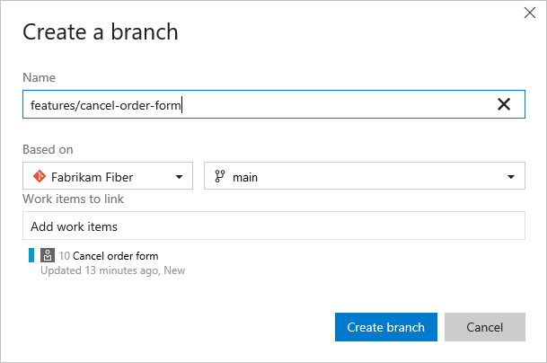

- Start work on the work item by creating a branch. You can add a new Git branch from within the Development section...   - ... or, from the form's  Actions menu. Actions menu.  - Name the branch and select the repository.   - When you create branches, they automatically get linked to the work item. - Note - You can only create a branch once you've added files to the main branch, which we recommend you label - mainor other distinctive label. The system automatically adds a README file to the initial repo created with each new project.

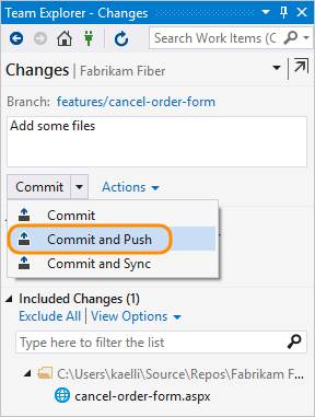

- Add or modify files in the branch that you created. - From Visual Studio or other supported IDE, commit and push changes from your local branch to the repository.  - If it's your first time pushing changes from a new branch, publish the branch before you push changes. For more information, see Share code with push.

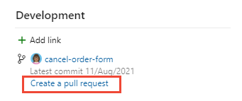

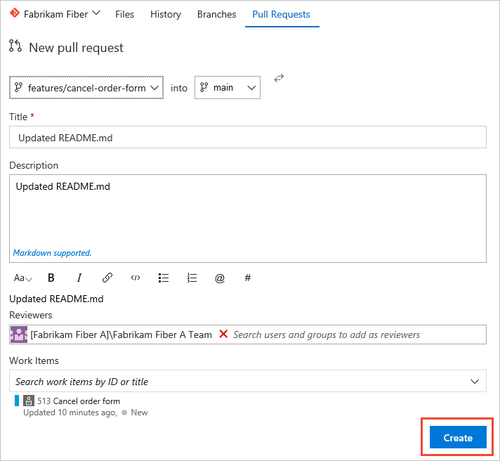

- Create a pull request from the work item form. - You create a pull request to merge the changes you made to a main branch and get your changes reviewed by other members of your team.
- Your view switches to Code, Pull Requests page. Complete creating the pull request as shown.  - Note - Once you've created a pull request, you can't create a new pull request for the same branch until you complete the previous pull request.  - Check the box for Squash changes when merging and then complete the merge.

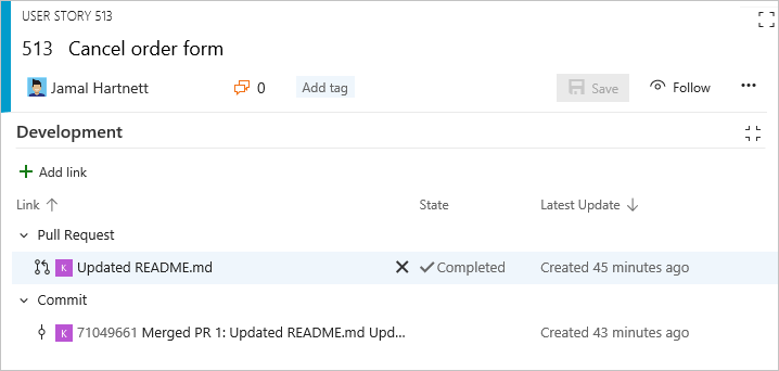

- Upon completion, you should see a similar screen as follows.
- Open the work item form or refresh the form, expand the Development section (choose Maximize Development  ), and you see the links that were added to support the operations you completed. ), and you see the links that were added to support the operations you completed.

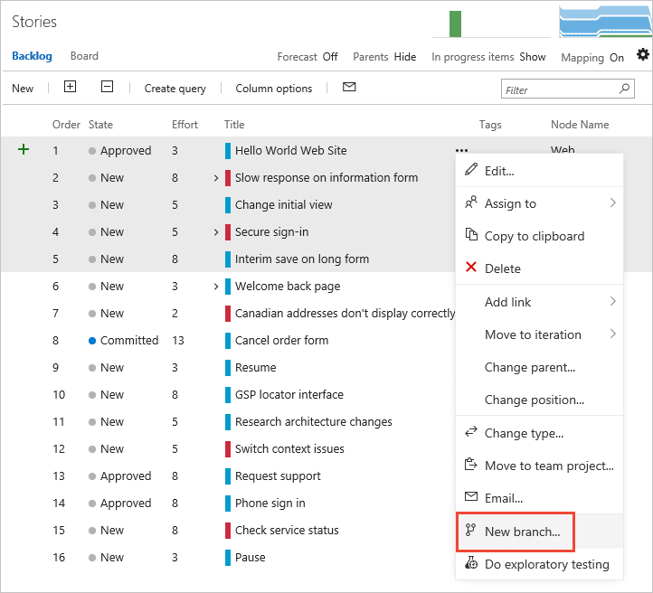

You can also add a new branch from the work item listed on the backlog or Kanban board without having to open the work item. Using multi-select, you can select several work items and create a new branch where they're all linked to the branch.
For example, here we select the first five items to link to a new branch.
And, we specify the name of the branch.
