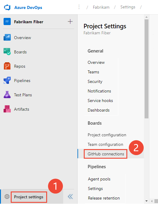

  3. Select Project settings > GitHub connections.
    Screenshot of open Project Settings, GitHub connections.

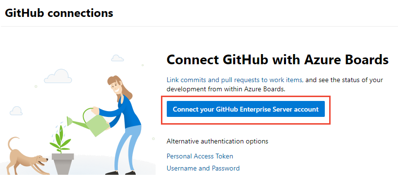

  4. If it's your first time making a connection from the project, choose the authentication method you want to use to make the connection:
    Screenshot of first time connecting with GitHub credentials.
    Otherwise, select New connection, and the select your authentication method from the New Connection dialog.

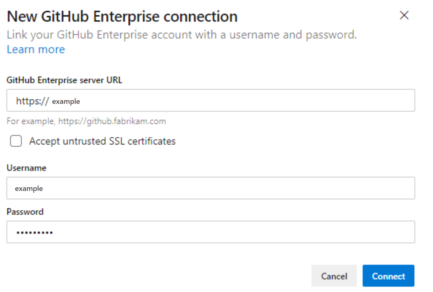

Connect Azure DevOps Server with GitHub credentials
  1. Enter the URL for your GitHub Enterprise server and the administrator account credentials recognized by that server. And then choose Connect.
    Screenshot of sign in with GitHub credentials.

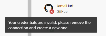

When the Azure Boards connection to GitHub no longer has access, it shows an alert status in the user interface with a red-X. Hover over the alert and it indicates that the credentials are no longer valid. To correct the problem, remove the connection and recreate a new connection.
Screenshot of failed connection.
