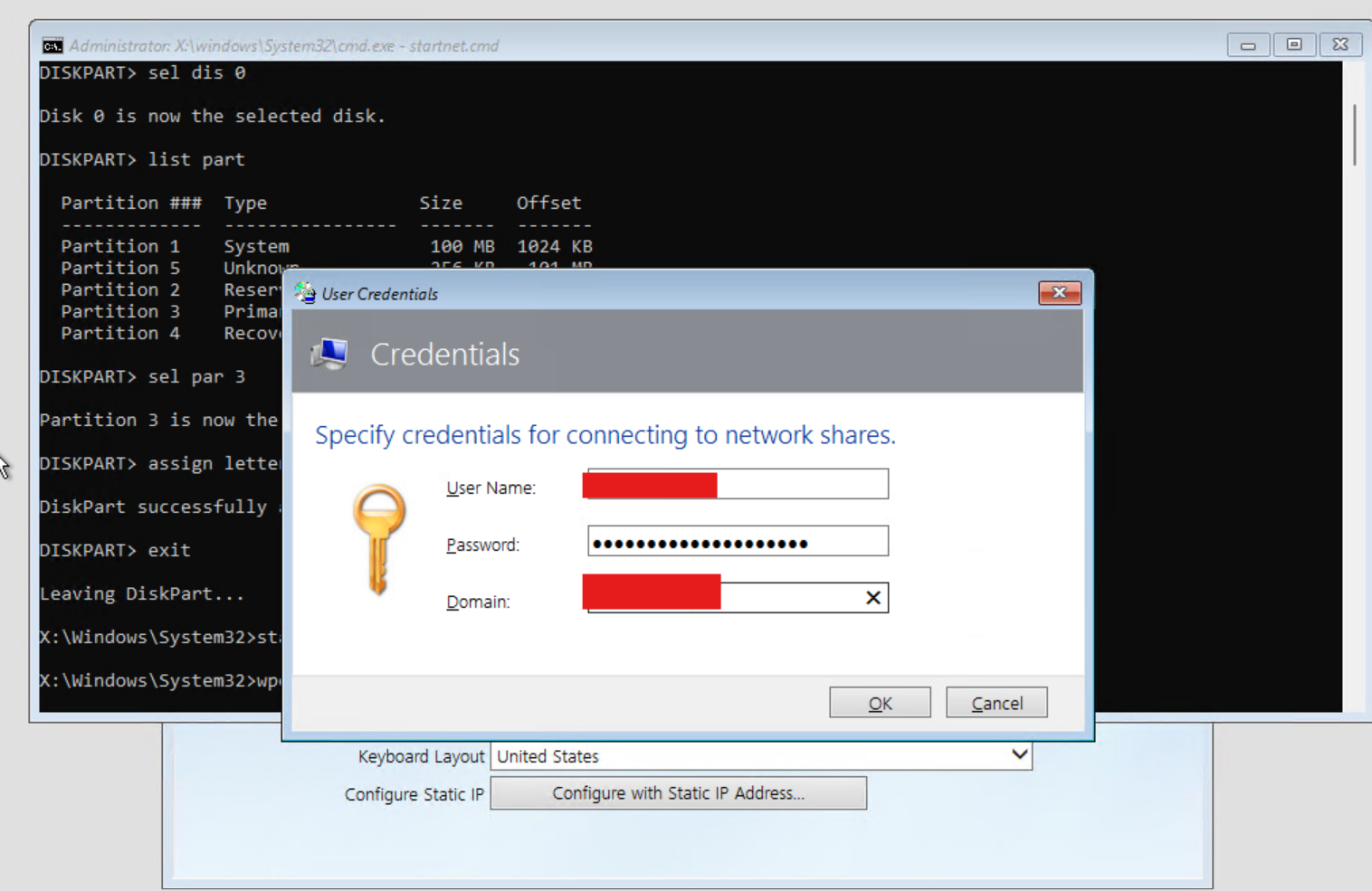

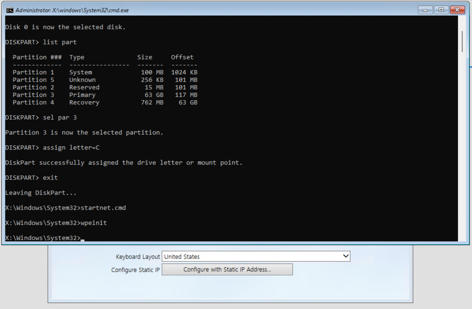

    OK I figured it out finally!...After three days of racking my head over this... I found answer on some other forums eventually...Its totally an ADK bug that needs to be resolved on Microsoft.. until then this is what need to be done...
    When the MDT task sequence boots to WinPE, and asks what you want to do (as opposed to just capturing the WIM like it's supposed to), exit to command line.
    Once there, go into disk part and assign the OS partition as c. In my case, the commands went something like:
    list disk
    select disk 0
    select part 3
    assign letter=c
    After that, I exited diskpart and ran "startnet.cmd" from the command line. ... the capture wim process now begins!
