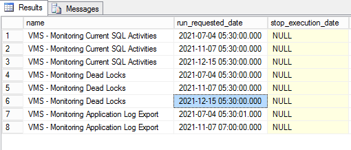

Hello,

Mostly it works perfectly but sometime we get this error:
Msg 22022, Sev 16, State 1: SQLServerAgent Error: Request to stop job Monitoring Current SQL Activities (from User NT AUTHORITY\LOCAL SERVICE) refused because the job is not currently running. [SQLSTATE 42000]
Msg 22022, Sev 16, State 1: SQLServerAgent Error: Request to stop job Monitoring Dead Locks (from User NT AUTHORITY\LOCAL SERVICE) refused because the job is not currently running. [SQLSTATE 42000]
Msg 22022, Sev 16, State 1: SQLServerAgent Error: Request to stop job Monitoring Log export (from User NT AUTHORITY\LOCAL SERVICE) refused because the job is not currently running. [SQLSTATE 42000]
I see there are multiple records for same job with NULL in stop_execution_date column of msdb.dbo.sysjobactivity table.

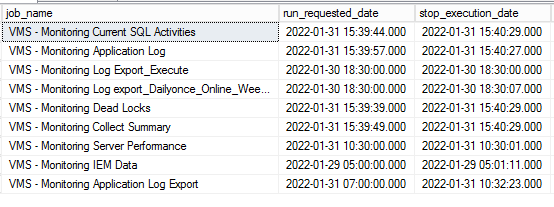

I also analyzed the result of stored procedure sp_help_jobactivity which displays the job status accurately.

  1. CathyJi-MSFT 22,401 Reputation points Microsoft External Staff
    2022-02-01T02:14:38.223+00:00
    Hi @anil kumar ,
    >Why there are multiple records with NULL in stop_execution_date column of msdb.dbo.sysjobactivity table on SQL Server 2014
    Each time the SQL Agent starts, it puts a new row in syssessions and subsequently any jobs run will get that session_id in sysjobactivity. For your jobs that have a null stop date, my guess is that they're not for the "current" session which would mean that they were still running when the agent was stopped.

    > If we use stored procedure sp_help_jobactivity to identify running job and then stopping them,, is it the perfect way to do that?
    I found an answer by Kenneth Fisher. The following query returns only currently running jobs:
    SELECT
        ja.job_id,
        j.name AS job_name,
        ja.start_execution_date,
        ISNULL(last_executed_step_id,0)+1 AS current_executed_step_id,
        Js.step_name
    FROM msdb.dbo.sysjobactivity ja
    LEFT JOIN msdb.dbo.sysjobhistory jh ON ja.job_history_id = jh.instance_id
    JOIN msdb.dbo.sysjobs j ON ja.job_id = j.job_id
    JOIN msdb.dbo.sysjobsteps js
        ON ja.job_id = js.job_id
        AND ISNULL(ja.last_executed_step_id,0)+1 = js.step_id
    WHERE
      ja.session_id = (
        SELECT TOP 1 session_id FROM msdb.dbo.syssessions ORDER BY agent_start_date DESC
    AND start_execution_date is not null
    AND stop_execution_date is null;
