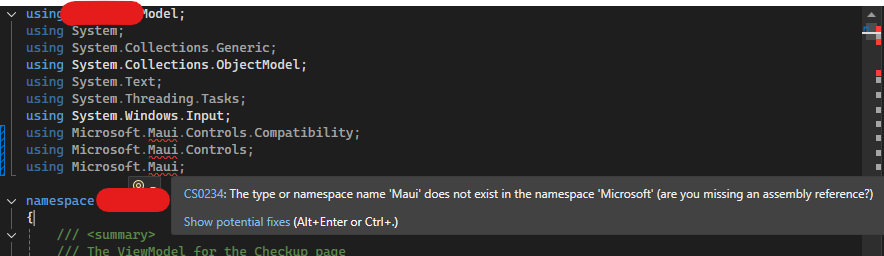

I tried to update my Xamarin project to MAUI dotnet8 using the .NET Upgrade assistant CLI and it went very poorly. I've been getting this error no matter what I do.

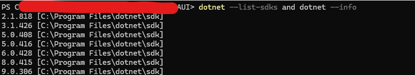

I checked to see if dotnet 8 was listed.User's image

I redid the CLI installation with dotnet9 and dotnet 10 at least 3 times each and I still get the same error. I redid the CLI for dotnet8 and I got the same issue. Most of them were side-by-side updates wherease one was an in-place upgrade done on a cloned repo. I still have the same issue every single time.
I re-installed dotnet8 and I STILL experience this problem.

When accessing the Microsoft library, nearly every single sub-library including Maui has the orange triangle on it with the tag Not Available on it. What exactly am I doing wrong and how can I fix this? It's been going on like this for a week!
This error occurs exclusively for the common Xamarin files of MyApp that MyApp.Droid and MyApp.iOS utilize. Files exclusively under MyApp.Droid and/or MyApp.iOS do not exhibit this problem. I do not see this error whatsoever in those two libraries, it's exclusively for the common code xamarin library
How do I fix the error of the common library?

    I completely understand how frustrating this must be, especially after spending so much time reinstalling SDKs, updating workloads, and even trying Copilot suggestions. You’ve already done a thorough job ruling out environment-related issues, so it’s very likely that the problem lies in how your shared/common project was converted during the Xamarin to .NET MAUI migration.
    Even when MAUI and .NET 8 are installed correctly, the shared project sometimes keeps parts of the old Xamarin setup, which causes Visual Studio to show the “namespace Microsoft.Maui does not exist” error. This usually happens when the project is still treated as a Xamarin library instead of a MAUI-compatible class library.
