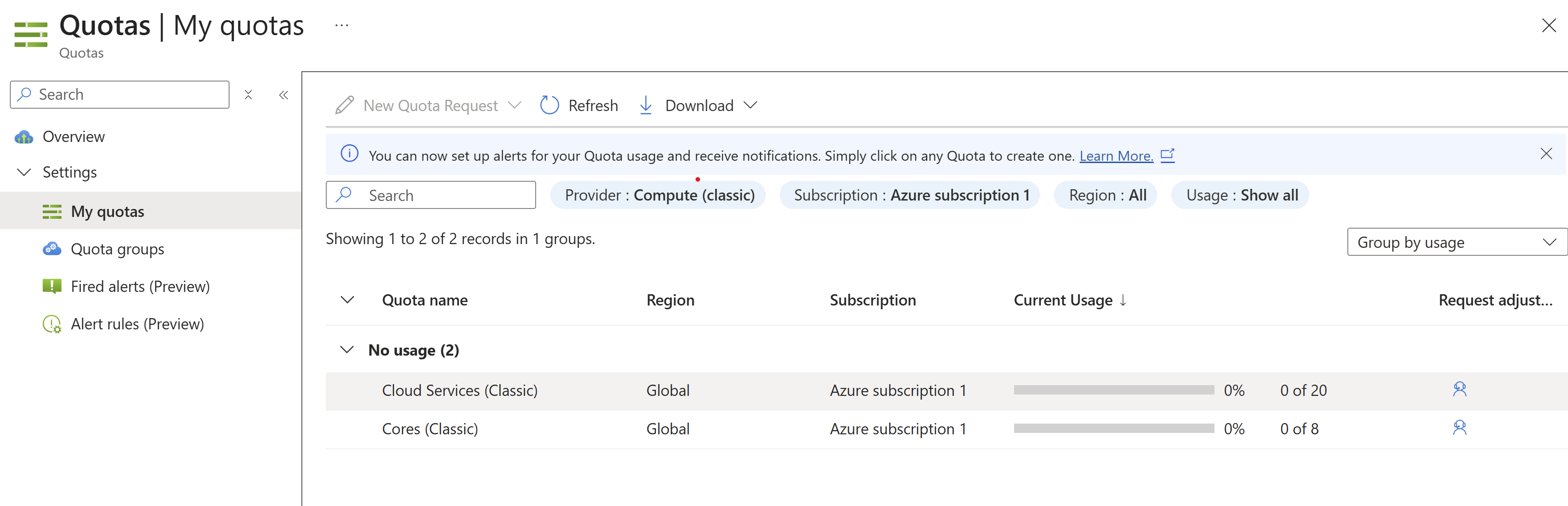

but I do not have any other web apps or any apps (beside an azure function). Furthermore, when I try to look up my quotas in the portal I see:
so, it looks like I do have two "classic" quotas unused
What am I doing wrong?
