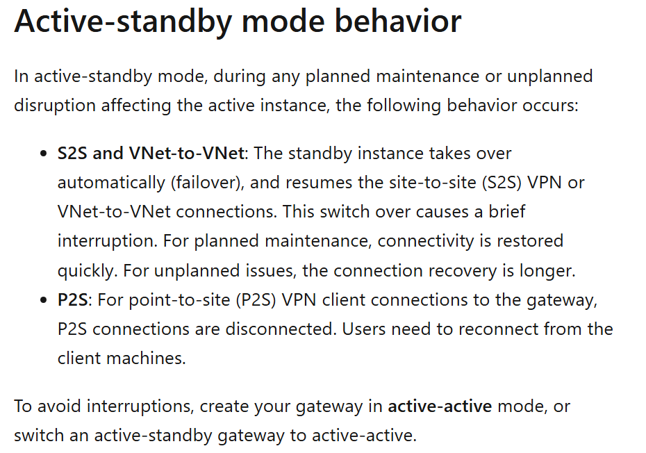

We have this message under resource health:
Unavailable (Unplanned) : (Unplanned)
At Friday, October 24, 2025 at 2:44:56 AM GMT+1, the Azure monitoring system received the following information regarding your Virtual Network Gateway:
We are sorry, your gateway is in standby mode. During this time the gateway will not initiate or accept connections with on premises devices or other Azure gateways.
Recommended Steps
  • Reset your Azure gateway
  • Verify if there is a network security group (NSG) applied to the GatewaySubnet
  • To get help recovering your gateway, contact support
I followed the instructions in the help section and tried resetting the gateway. That was reported as succeeding. We still couldn't connect.
Connections have been attempted from PCs at different locations so the issue is not local to the VPN clients.
