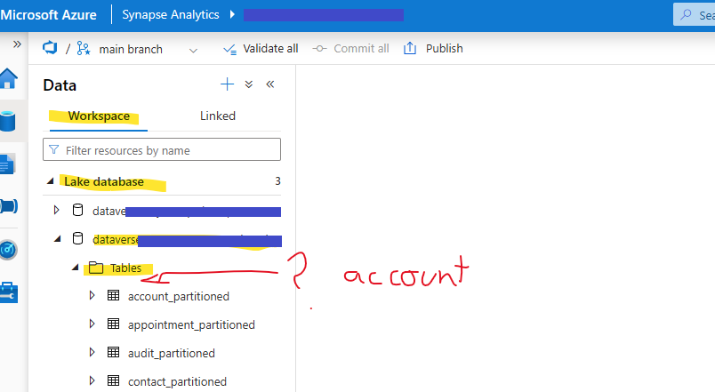

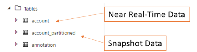

According to this we should see a near real-time table and a snapshot table in our Azure Synapse Analytics environment but the near real-time table is missing.

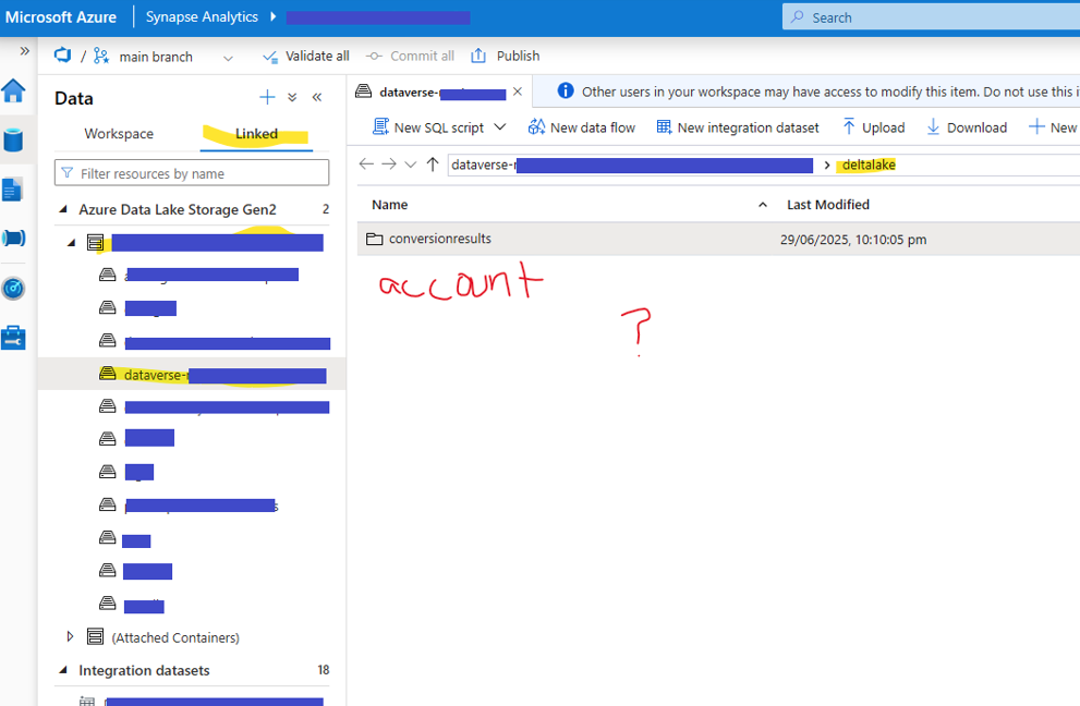

Similarly the delta files have never been created in the appropriate /deltalake folder of our ADLS Gen2 storage location:

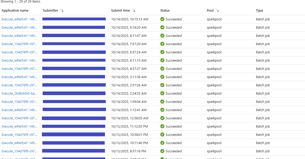

 The spark pool appears to be writing the csv's correctly to the target folders in our storage account ADLS Gen2 and the spark job states that it was successful in synapse workspace.

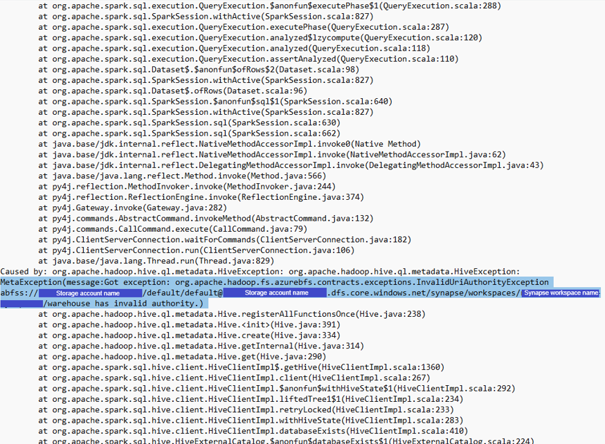

However when I dig into the logs of the spark executions there's an error in the DeltaConversion job stating "invalid authority" when trying to access the default workspace storage location. It's referring to an abfss path that looks incorrect to me as it's in the format of:
  • abfss://[mystorageaccount]/default/default@[mystorageaccount].dfs.core.windows.net/synapse/workspaces/[mysynapseworkspace]/warehouse
 I am assuming it should be in the format of:
  • abfss://default@[mystorageaccount].dfs.core.windows.net/synapse/workspaces/[mysynapseworkspace]/warehouse

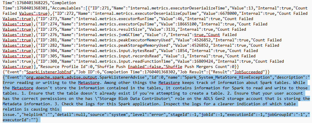

There is also an error reading / writing to the metastore.

    1. The delta conversion is failing because the ABFSS URI is malformed, the container/account parts are swapped and an extra path segment appears: abfss://[mystorageaccount]/default/default@[mystorageaccount].dfs.core.windows.net/... instead of the correct form: abfss://<container>@<storageaccount>.dfs.core.windows.net/<path>
    2. That malformed URI produces an "invalid authority" error and prevents delta files / near real-time table from being created.
