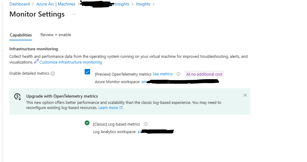

The setup is pretty straightforward, you click 'Configure', in the Capabilities, the 'Preview OpenTelemetry metrics' check box is checked and you select the Azure Monitor Workspace (I created a new one when setting up the first machine), you click 'Review + enable' and it is done.
For each machine I got a message 'Onboarding has completed. Data may take a few minutes to start flowing while configuration syncs.' .

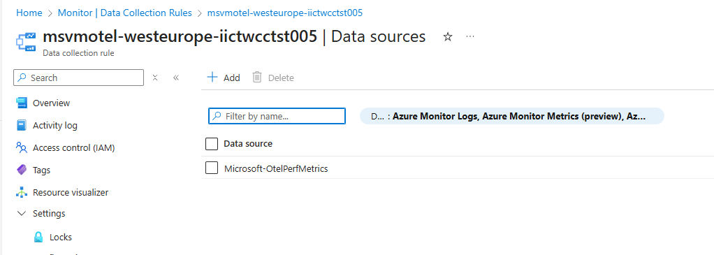

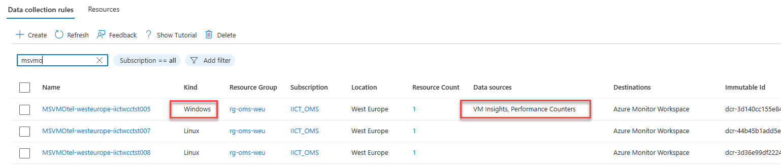

I don't know if this could be the problem but when I check the DCRs, I see that a DCR is created for each machine and the platform type of the DCR is set to 'Linux' ! (my test servers are Windows machines)
I can't find any way to change that setting.
If I try to create a new DCR, I can't find the Microsoft-OtelPerfMetrics in the Data source list.

    I have tried to create a DCR through an ARM template but it doesn't seem to work.
    Yes, now, it says Windows, but the data sources are not displaying correct values and if I open the DCR it says that the data source is Microsoft-OTelPerfMetrics :
    I applied this DCR to a machine and waited .
    Unfortunately, still nothing for the Metrics based visualization, it says 'no events'.

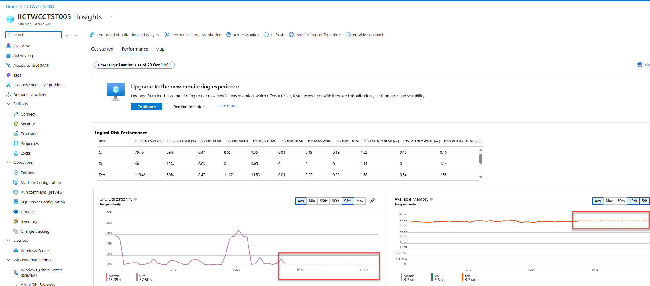

    Applying this DCR also 'killed' the insights through log analytics :
    And the message to onboard the machine to the new monitoring experience is back.
    So the DCR created, even if the validation was ok, is not good.

    I completely understand that seeing only Microsoft-OTelPerfMetrics would tell that no metrics ingestion would be done through Log Analytics but when you configure the new monitoring experience, you clearly configure that the system you continue the ingestion into the Log Analytics workspace :
    But also, the servers are still in the resources list from the DCR that configures the ingestion into Log Analytics so it should never stop sending data there.

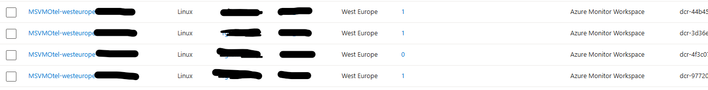

    At the moment, it is still not working because the DCR created for each machine is still for Linux and not Windows :
