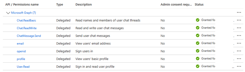

I created my application in Azure. I enabled the following permissions:
After I logged in to my Application wich is MS 365 account with SSO, and I want to get the chats with the accessToken. The access token is absolutely right.

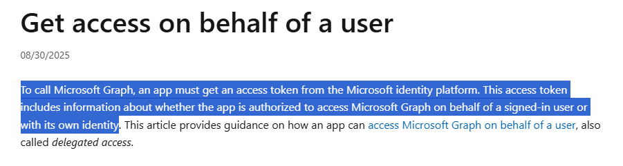

    Additionally, I noticed you mentioned using SSO. Could you clarify why this approach was chosen? For Microsoft Graph API calls, the token must be an access token (not just an ID token) to work correctly.

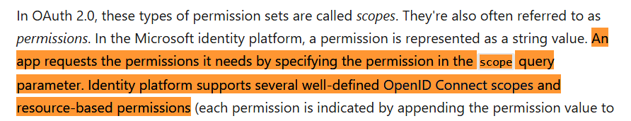

    Also, kindly please ensure that you have all the required permissions and scopes for the chat endpoint, you can find the complete list in this Microsoft Article here. As 401 error often indicates that the token does not include the necessary permissions and scopes.

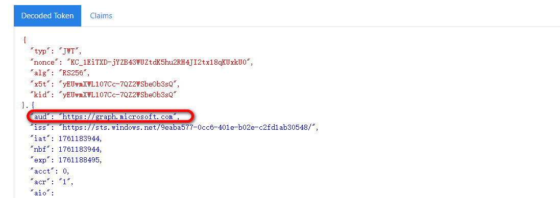

    From https://jwt.ms/, You can see the result:
    Then I used that token to get chats through API.

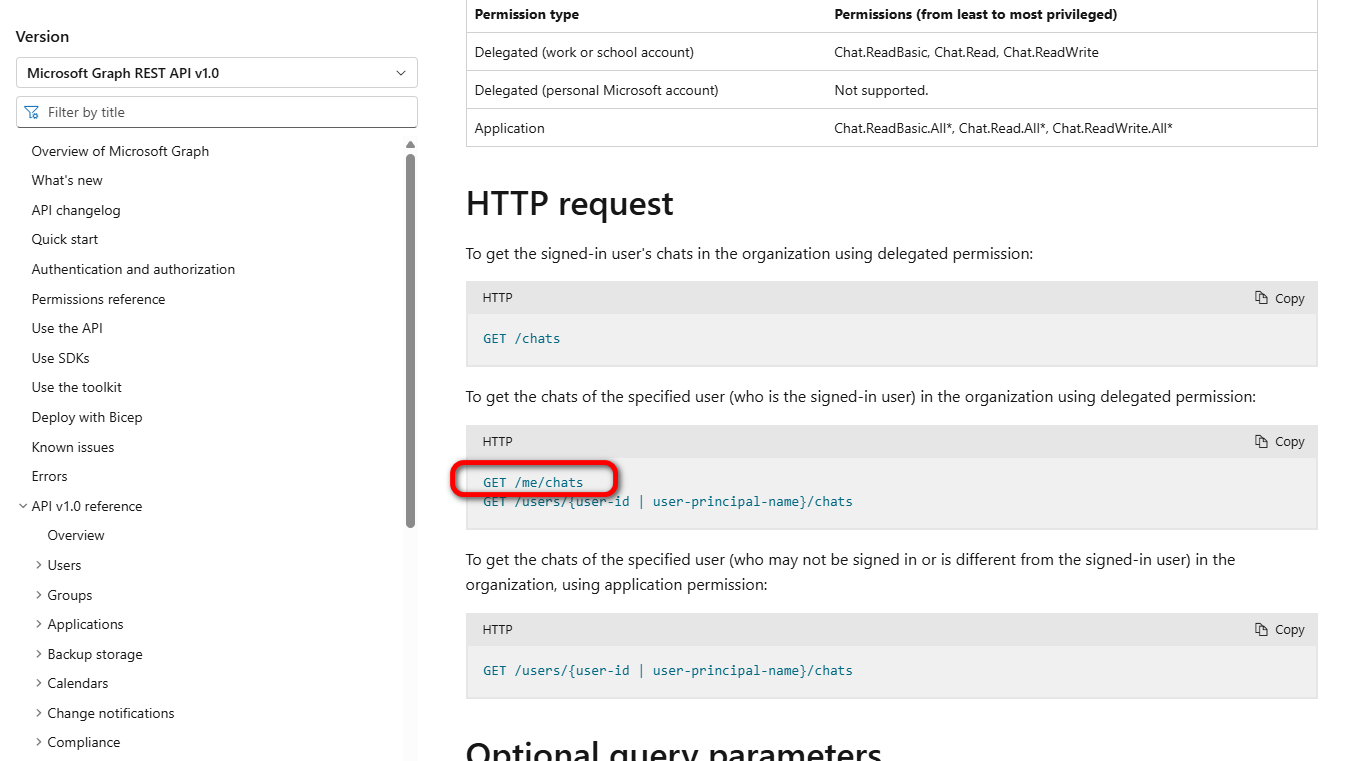

    curl --location 'https://graph.microsoft.com/v1.0/me/chats' \
    --header 'Authorization: Bearer <token>'
    401 error happened.
