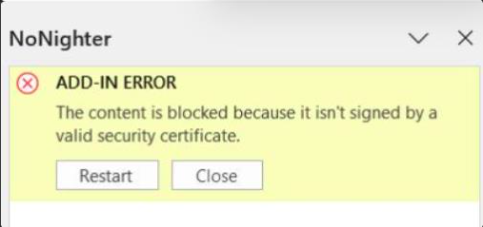

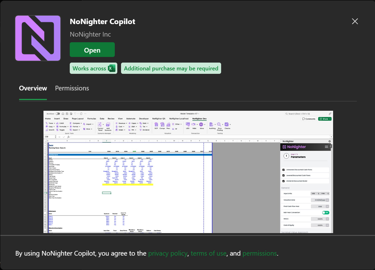

We developed an Excel Web Add-In and published to Office Store (it's called NoNighter Copilot and free to install). User's image
We are having an issue with one of our clients (other clients can use the add-in without problem). This error is well known on localhost environments with self-signed certificates, but in production all requests are being done with HTTPS with valid certificates.
I suspect the error is related to something else, but as the web add-in is failing locally, I cannot see anything in server side.
What do you suggest might be blocking the add-in to load? Some Excel or Windows config? A firewall or antivirus?
What tools do we have to debug this type of errors?
Thanks in advance

    Thank you for reaching out to Microsoft Q&A Forum and sharing your detailed inquiry with screenshots regarding the issue with your NoNighter Copilot add-in. I understand how confusing it can be to encounter certificate-related challenges with Office Add-ins, especially when they affect only a single client while working smoothly for others.
    The error message “The content is blocked because it isn’t signed by a valid security certificate” generally signifies that Excel is unable to validate the SSL/TLS certificate associated with the add-in’s resources. While this is common in development with self-signed certificates, seeing it in production may suggest an environmental or configuration issue on the client’s side as the issue impacts only one client.

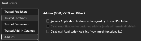

    Enable Office Add-in Debugging: In Excel, go to Options > Trust Center > Trust Center Settings > Add-ins and ensure “Require Application Add-ins to be signed by Trusted Publisher” is unchecked for testing purposes. User's image
    Note: The troubleshooting is mostly client-side, but confirming your server certificate configuration first is essential.
