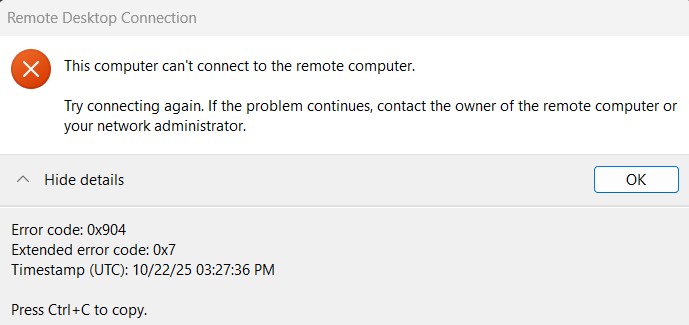

I had attempted to troubleshoot the connectivity with the Connect section of my VM. I even downloaded the RDP file that the tool offers. Nothing seems to work. What I've noticed is that I try to connect a random, blatantly wrong IP address, RDP will spin and spin for a bit and then give up, telling it was unable to connect. But when I attempt to connect to my VM, the connection attempt fails immediately with the same error message:
Screenshot 2025-10-22 112808
