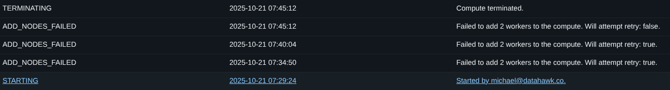

Then I created a cluster with nodes assigned to the pools, and when I try to start it, it fails with the following error :
Here are the details:
  "reason": {
    "code": "CONTAINER_LAUNCH_FAILURE",
    "type": "SERVICE_FAULT",
    "parameters": {
      "databricks_error_message": "The VM launch failed due to container setup failure, please try again later. [details] CONTAINER_LAUNCH_FAILURE: Container failed to be launched on the instance",
      "azure_error_code": "CONTAINER_LAUNCH_FAILURE",
      "azure_error_message": "Container failed to be launched on the instance"
  "add_node_failure_details": {
    "failure_count": 2,
    "resource_type": "container",
    "will_retry": true

  1. VRISHABHANATH PATIL 1,295 Reputation points Microsoft External Staff Moderator
    2025-10-21T08:36:52.4966667+00:00
    Hi @Michael Guirao
    Thank you for posting your question on Microsoft Q&A. Here are some troubleshooting steps that may help address your issue.
    You are encountering a CONTAINER_LAUNCH_FAILURE error when starting a Databricks cluster with enable_elastic_disk set to false. This typically happens because the cluster cannot provision the required disk configuration when elastic disk is disabled.
    Why This Happens
    • Elastic Disk Behavior: By default, Databricks uses elastic disk to dynamically attach additional storage when the local disk runs out of space. Disabling it (enable_elastic_disk=false) forces the cluster to rely solely on the ephemeral local disk provided by the VM SKU.
    • Impact of Disabling Elastic Disk: If the selected VM SKU does not have sufficient local storage for Databricks system containers and Spark workloads, the container launch will fail. This is especially common with spot instances or smaller VM sizes.
    • Azure Container Setup Failure: The error message indicates that the container could not be launched because the node did not meet the storage requirements for Databricks runtime when elastic disk was disabled.
    Suggested Solutions
    Takeaways
    • Disabling enable_elastic_disk is only safe when you are certain the VM SKU provides enough local storage for Databricks system and Spark workloads.
    For most production and development scenarios, keep elastic disk enabled to avoid container launch failures.
