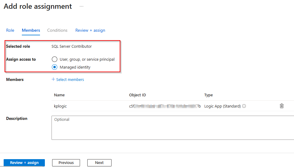

    Navigate to SQL Server -> Access Control (IAM) -> Role assignment, grant SQL Server Contributor role to Managed Identity of your logic app.

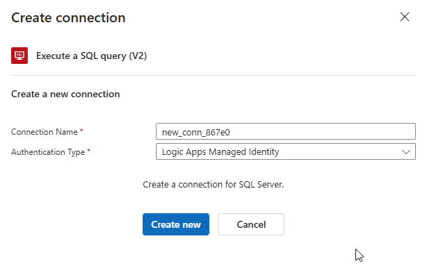

    Create a connection to Azure SQL server through Logic app Designer. Enable Public access for selected networks.
    • Add the SQL Action
    Click **+ =>**Search for **"SQL Server"=>**Choose "Execute a SQL query (V2)" =>Create or Select Connection
    • A connection form will pop up=> Enter the server's name servername.database.windows.net and Database name by selecting Enter custom value.

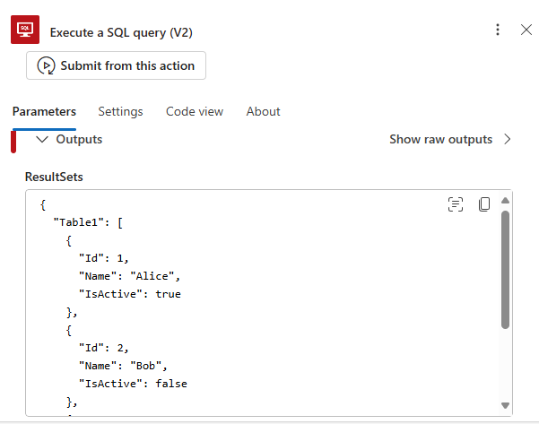

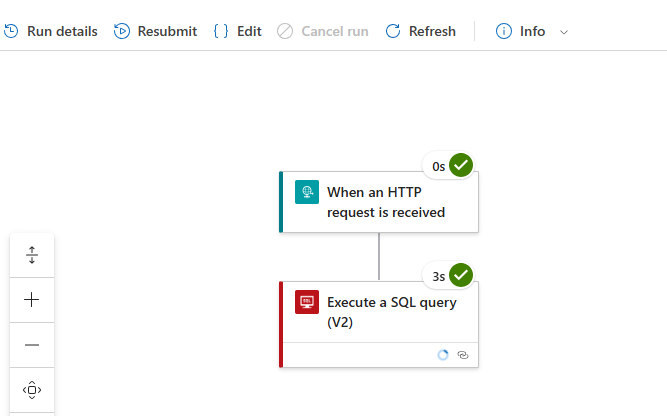

    • Run the Http Post URL using curl or Postman to execute the query (add parameters if needed).
    Run History:image Output:
    image Hope it helps!
