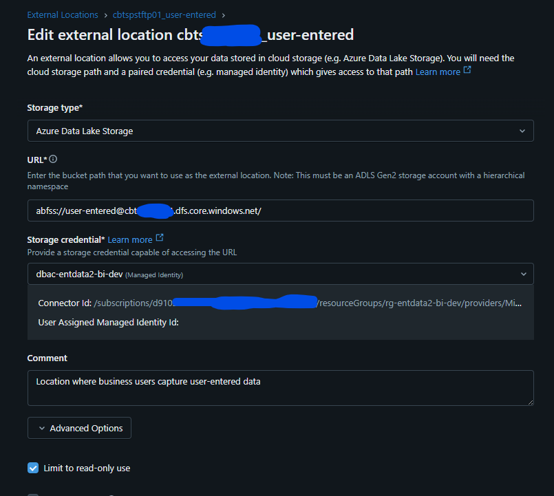

In Azure Databricks, I created an External Location and Credentials to access ADLS Gen2 storage container. I have the proper Unity Catalog permissions and the "Storage Blob Data Reader" role on the container. Unity catalog can browse the folders / files in the container, but I get "PERMISSION_DENIED" when attempting to access via compute, including Serverless SQL Warehouse or Serverless in a notebook.
I verified the appropriate Unity Catalog permissions are in place. If I add "Storage Blob Data Reader" role at the ADLS account-level, everything will work as expected. However, Databricks should only have access to specific containers, so I am not able to assign account-level permissions in this case.
I believe this may be a bug in how Databricks attempts to read the external location from compute? Since UC can browse the files without issue, and container-level permissions should be sufficient, this seems like an implementation issue where Databricks attempts some command that requires escalation.
Is this a limitation of Databricks external locations (that it cannot support container-level access)?

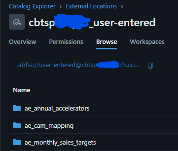

Here I can browse the external location directly in Unity Catalog:
