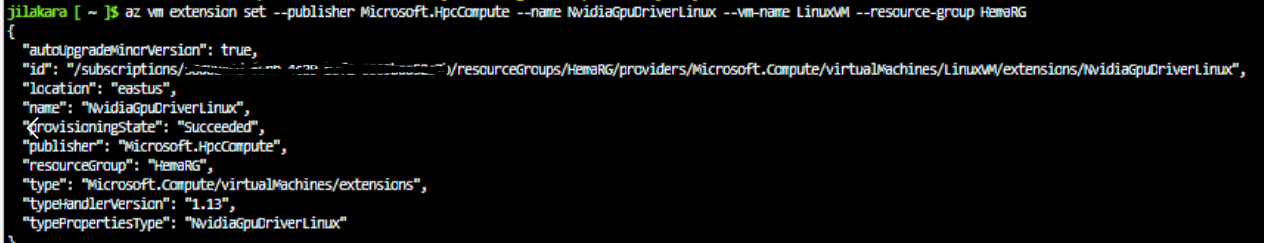

    Could you please follow below steps:
    1. If you have any existing drives uninstall all existing NVIDIA drivers to start from a clean state or alternatively, you can create a new VM to ensure a clean environment.
    2. After creating the VM. Enable the NVIDIA GPU Driver Extension for Linux using this CLI command:
    az vm extension set --publisher Microsoft.HpcCompute --name NvidiaGpuDriverLinux --vm-name <your-vm-name> --resource-group <your-rg>
    This installs and configures the validated NVIDIA driver automatically, ensuring compatibility with the Azure kernel and persistence across reboots.User's image

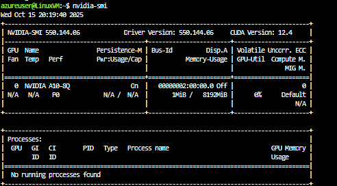

    1. Login to the VM and verify the drive details:
    nvidia-smi
    Reference: https://free.blessedness.top/en-us/azure/virtual-machines/extensions/hpccompute-gpu-linux
    https://free.blessedness.top/en-us/azure/virtual-machines/linux/n-series-driver-setup#supported-distributions-and-drivers
    Hope this helps! You should now be able to view the NVIDIA driver details successfully. Please let me know if you have any further questions or if the issue persists after these steps.
