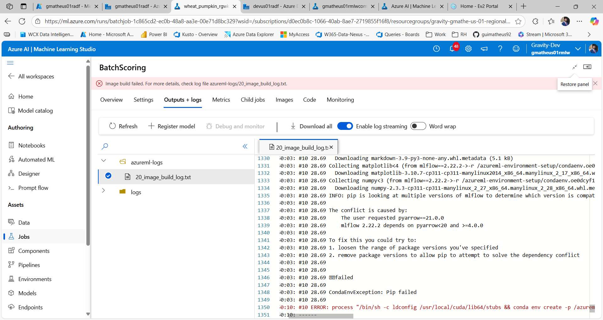

I don't know if that is the problem, but I was getting error of pyarrow version:
But after I updated my environment, I got the error I shared above. But, the interesting thing is that I am not using my custom environment in this batch deployment because we don't have a scoring script, so we wanted to use the auto-generated scoring script instead.

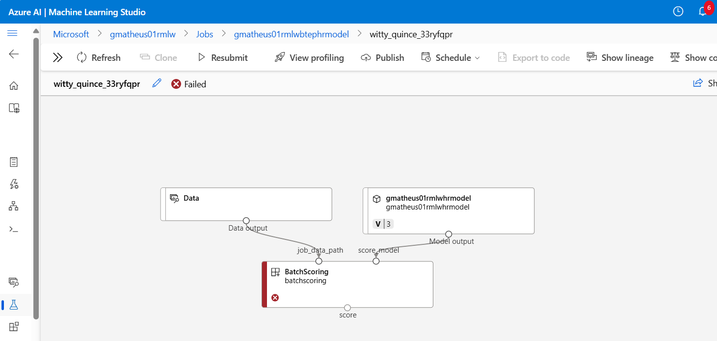

My failed batch:
By the way, this job was submitted by ADF using REST API.
