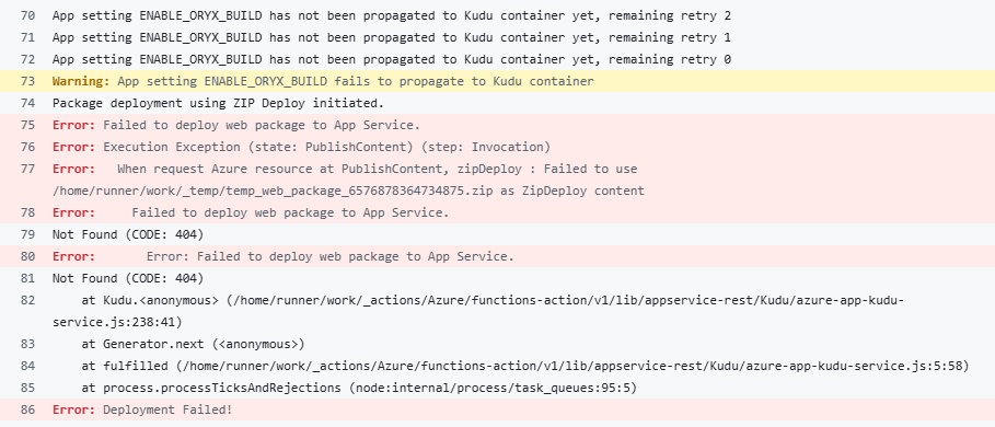

My app is a dummy app in python 3.12 just to check the pipeline building. I use the .yml from the template provided by azure.
I get this error:
Successfully parsed SCM credential from publish-profile format.
Using SCM credential for authentication, GitHub Action will not perform resource validation.
Successfully acquired app settings from function app (with SCM credential)!
Will archive . into /home/runner/work/_temp/temp_web_package_8123595537315715.zip as function app content
Will use Kudu https://<scmsite>/api/zipdeploy to deploy since publish-profile is detected.
Setting SCM_DO_BUILD_DURING_DEPLOYMENT in Kudu container to true
Update using context.kuduService.updateAppSettingViaKudu
Response with status code 405
App setting SCM_DO_BUILD_DURING_DEPLOYMENT has not been propagated to Kudu container yet, remaining retry 19
App setting SCM_DO_BUILD_DURING_DEPLOYMENT has not been propagated to Kudu container yet, remaining retry 18
App setting SCM_DO_BUILD_DURING_DEPLOYMENT has not been propagated to Kudu container yet, remaining retry 17
App setting SCM_DO_BUILD_DURING_DEPLOYMENT has not been propagated to Kudu container yet, remaining retry 16
App setting SCM_DO_BUILD_DURING_DEPLOYMENT has not been propagated to Kudu container yet, remaining retry 15
App setting SCM_DO_BUILD_DURING_DEPLOYMENT has not been propagated to Kudu container yet, remaining retry 14
App setting SCM_DO_BUILD_DURING_DEPLOYMENT has not been propagated to Kudu container yet, remaining retry 13
App setting SCM_DO_BUILD_DURING_DEPLOYMENT has not been propagated to Kudu container yet, remaining retry 12
App setting SCM_DO_BUILD_DURING_DEPLOYMENT has not been propagated to Kudu container yet, remaining retry 11
App setting SCM_DO_BUILD_DURING_DEPLOYMENT has not been propagated to Kudu container yet, remaining retry 10
App setting SCM_DO_BUILD_DURING_DEPLOYMENT has not been propagated to Kudu container yet, remaining retry 9
App setting SCM_DO_BUILD_DURING_DEPLOYMENT has not been propagated to Kudu container yet, remaining retry 8
App setting SCM_DO_BUILD_DURING_DEPLOYMENT has not been propagated to Kudu container yet, remaining retry 7
App setting SCM_DO_BUILD_DURING_DEPLOYMENT has not been propagated to Kudu container yet, remaining retry 6
App setting SCM_DO_BUILD_DURING_DEPLOYMENT has not been propagated to Kudu container yet, remaining retry 5
App setting SCM_DO_BUILD_DURING_DEPLOYMENT has not been propagated to Kudu container yet, remaining retry 4
App setting SCM_DO_BUILD_DURING_DEPLOYMENT has not been propagated to Kudu container yet, remaining retry 3
App setting SCM_DO_BUILD_DURING_DEPLOYMENT has not been propagated to Kudu container yet, remaining retry 2
App setting SCM_DO_BUILD_DURING_DEPLOYMENT has not been propagated to Kudu container yet, remaining retry 0
Warning: App setting SCM_DO_BUILD_DURING_DEPLOYMENT fails to propagate to Kudu container
Setting ENABLE_ORYX_BUILD in Kudu container to true
App setting ENABLE_ORYX_BUILD has not been propagated to Kudu container yet, remaining retry 19
App setting ENABLE_ORYX_BUILD has not been propagated to Kudu container yet, remaining retry 18
App setting ENABLE_ORYX_BUILD has not been propagated to Kudu container yet, remaining retry 17
App setting ENABLE_ORYX_BUILD has not been propagated to Kudu container yet, remaining retry 16
App setting ENABLE_ORYX_BUILD has not been propagated to Kudu container yet, remaining retry 15
App setting ENABLE_ORYX_BUILD has not been propagated to Kudu container yet, remaining retry 14
App setting ENABLE_ORYX_BUILD has not been propagated to Kudu container yet, remaining retry 13
App setting ENABLE_ORYX_BUILD has not been propagated to Kudu container yet, remaining retry 12
App setting ENABLE_ORYX_BUILD has not been propagated to Kudu container yet, remaining retry 11
App setting ENABLE_ORYX_BUILD has not been propagated to Kudu container yet, remaining retry 10
App setting ENABLE_ORYX_BUILD has not been propagated to Kudu container yet, remaining retry 9
App setting ENABLE_ORYX_BUILD has not been propagated to Kudu container yet, remaining retry 8
App setting ENABLE_ORYX_BUILD has not been propagated to Kudu container yet, remaining retry 7
App setting ENABLE_ORYX_BUILD has not been propagated to Kudu container yet, remaining retry 6
App setting ENABLE_ORYX_BUILD has not been propagated to Kudu container yet, remaining retry 5
App setting ENABLE_ORYX_BUILD has not been propagated to Kudu container yet, remaining retry 4
App setting ENABLE_ORYX_BUILD has not been propagated to Kudu container yet, remaining retry 3
App setting ENABLE_ORYX_BUILD has not been propagated to Kudu container yet, remaining retry 2
App setting ENABLE_ORYX_BUILD has not been propagated to Kudu container yet, remaining retry 0
Warning: App setting ENABLE_ORYX_BUILD fails to propagate to Kudu container
Package deployment using ZIP Deploy initiated.
Error: Failed to deploy web package to App Service.
Error: Execution Exception (state: PublishContent) (step: Invocation)
Error: When request Azure resource at PublishContent, zipDeploy : Failed to use /home/runner/work/_temp/temp_web_package_8123595537315715.zip as ZipDeploy content
Not Found (CODE: 404)
Error: Error: Failed to deploy web package to App Service.
at Kudu.<anonymous> (/home/runner/work/_actions/Azure/functions-action/v1/lib/appservice-rest/Kudu/azure-app-kudu-service.js:238:41)
at Generator.next (<anonymous>)
at fulfilled (/home/runner/work/_actions/Azure/functions-action/v1/lib/appservice-rest/Kudu/azure-app-kudu-service.js:5:58)
at process.processTicksAndRejections (node:internal/process/task_queues:95:5)
Error: Deployment Failed!

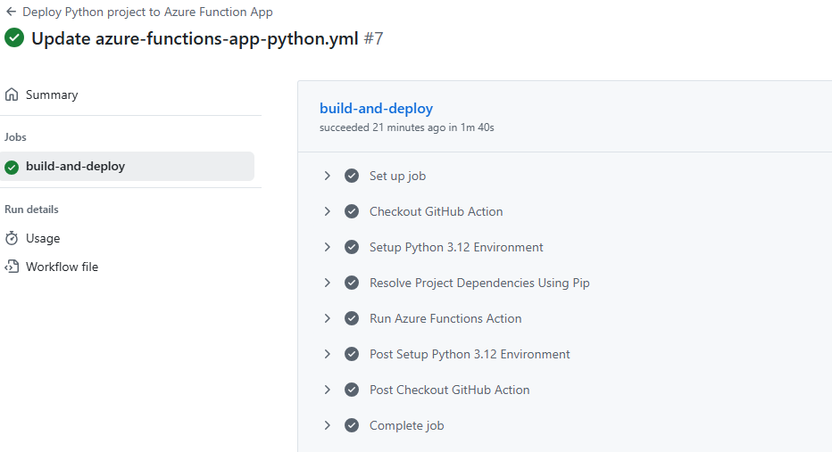

    I faced the same issue when deploying a function to a Function App on the Flex Consumption plan using GitHub Actions.
    • Are you using Flex Consumption plan?
    If yes, make sure to add below set of parameters in your generated GitHub yaml file:
    		sku: 'flexconsumption'
            remote-build: true
    Example:
          with:
            app-name: ${{ env.AZURE_FUNCTIONAPP_NAME }}
            package: ${{ env.AZURE_FUNCTIONAPP_PACKAGE_PATH }}
            remote-build: true
            publish-profile: ${{ secrets.AZURE_FUNCTIONAPP_PUBLISH_PROFILE }} # Remove publish-profile to use Azure RBAC
            scm-do-build-during-deployment: true
            enable-oryx-build: true
    I have followed the same steps and MSDOC and I could deploy the function to Azure.

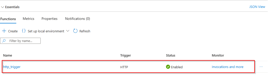

  2. Dario Castellon 5 Reputation points
    2025-10-22T10:25:26.04+00:00
    Thanks for the help.
    I have a walk through by using the Azure CLI in the workflow instead of letting the oryx to build and deploy the function. This sample workflow worked for solving the issue:
