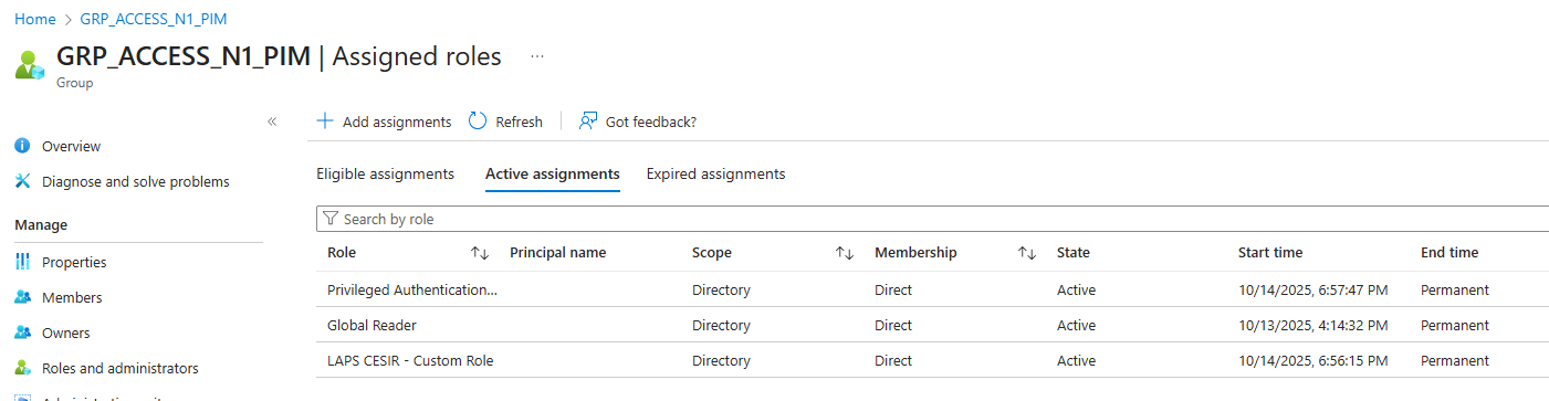

We have 3 roles permanently active on a specific group for PIM access. When the eligibles members of this group active JIT access, roles don't apply on her profil. I don't understand why, configuration seems ok.User's image

    I can see that your group GRP_ACCESS_N1_PIM has several permanent active directory roles (Privileged Authentication, Global Reader, and LAPS Custom Role). From your description, the configuration seems correct, but the issue occurs when eligible members activate their Just-In-Time (JIT) access and the group-based roles are not reflected on their profile. Let’s go step by step to isolate the cause:

    • Go to Azure AD → Privileged Identity Management → Azure AD Roles → Groups (tab) and confirm the group’s state is Active, not Eligible.
