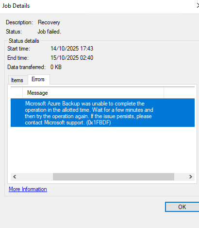

When attempting to restore a file via File and Folders from a restore point with Azure Agent, it takes a long time to mount the disk. However, once it is mounted, I am unable to access it. When I browse, it keeps loading until it gives an invalid parameters error, and I am unable to access the disk. I have already updated the Azure agent to the latest version.

Focagem Soluções de Gestão • 0 Reputation points
2025-10-15T10:46:48.0533333+00:00 -
Siva shunmugam Nadessin • 1,990 Reputation points • Microsoft External Staff • Moderator
2025-10-16T00:47:57.0933333+00:00 Hello Focagem Soluções de Gestão
This indicates a timeout during a recovery job. Here’s how you can troubleshoot and resolve it.
2025-10-17T11:04:04.4166667+00:00 Splitting the restore into smaller chunks." how, it only allow me to chose partion V:\ nothing more
Still have the same probleme, Btw before the error occors, it first fail to open the mounted drive"Invalid parameters"
