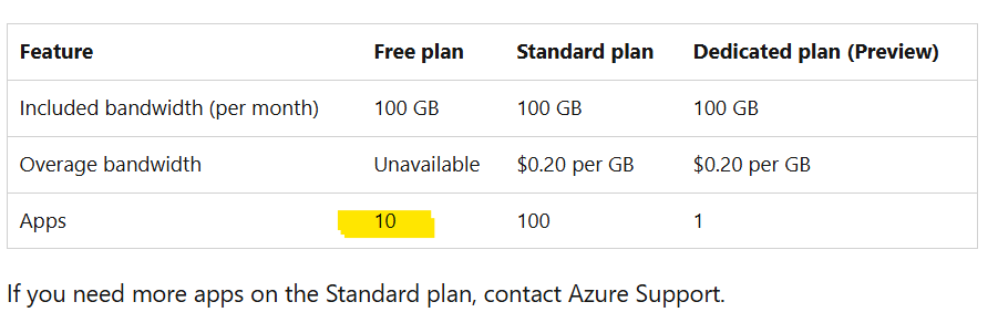

I’ve reached the limit of 10 Static Web Apps in the Free tier for my Azure subscription.
I have an active Developer Support Plan but the Azure Portal doesn’t allow me to open a technical support ticket for this service. It only redirects me to Microsoft Q&A.
I need to know if there’s any way to increase the quota of Static Web Apps (Free SKU) beyond 10 per subscription, or if Microsoft can manually extend this limit for my tenant.
If not, please confirm whether creating additional subscriptions is the only supported workaround to deploy more than 10 free Static Web Apps.

    Azure limits each subscription to 10 Static Web Apps on the Free tier, and this limit cannot be raised, even with a Developer Support Plan.
    To use more Free-tier apps, you will need to create additional subscriptions, as each one allows up to 10 Static Web Apps.
    Alternatively, upgrading to the Standard SKU gives you the ability to manage more apps within a single subscription, along with higher quotas and production-level SLAs.

    Documentation only says to contact support if you need more apps on Standard plan, so I'm unsure if they will allow you to increase Free plan limit. My guess is they will not, but you can try.
    In the past there have been cases where documentation didn't mention ability to increase a limit, however, when I submitted request they increased it. There is no charge to make request.
