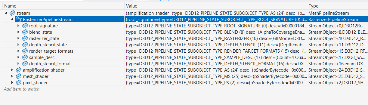

The issue is that I'm actually not specifying any topology in the PSO description (since it is not needed). You can see the helper struct I use below and there the only use of primitive topology is when I'm using the vertex pipeline (which I'm not when I get this error).
template
See here the stream object I'm passing into CreatePipelineState: User's image

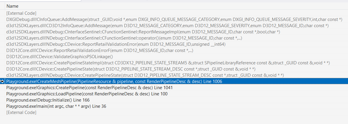

Looking at the DirectX call stack when I hit the error, it looks like perhaps my stream description is being duplicated into a CD3DX12_PIPELINE_STATE_STREAM5 object by DirectX. If this object is anything like the public struct of a similar name, it contains all possible sub-object descs including the topology one. I think DirectX is making an assumption here that the mesh shader topology is triangle and therefore auto-populating the topology with a mismatching type for my line mesh shader. User's image
There's no way for me to fix this in my calling code since I'm already doing the right thing (and the thing that the error itself suggests!). I concede that I would be a bit surprised if my hypothesis is true since that would indicate that there are no DirectX tests for line mesh shaders.
