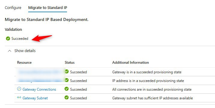

I was trying to Migrate to Standard IP for my Virtual network gateway (non-az sku), active-passive with built within portal "Migrate to Standard IP Based Deployment".
Despite Azure validation is showing "Succeeded" (this is a bug i think) after click "Prepare" it turned out that Gatewy Subnet is too small (is /29).migration1

    The InUsePrefixCannotBeDeleted error occurred because your PowerShell command tried to modify the existing /29 GatewaySubnet (10.0.122.0/29), which is actively used by the VPN Gateway.
    Azure locks in-use prefixes to prevent disruption of allocated IPs. Additionally, a /29 subnet is too small for migrating to a Standard Public IP, which requires /27 or larger. This explains why the "Prepare" step failed despite the portal showing "Succeeded."
