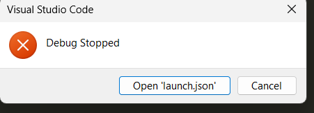

This is what my VS code is displaying even when i try to debug a simple python file of print("Hello World"). I have used Vs code for about a year now and it has never happened. I even re-installed it but it still displays the same. I have even changed the launch.json configurations to those recommended by CO-PILOT but all in vain. I even re-installed the extensions. However, the program runs well. {Python Programmer here}

    I rolled back Python Debugger extension to 2025.10, and it started working.
  2. David Cleland 0 Reputation points
    2025-10-10T13:51:24.1766667+00:00
    I literally just hit this while investigating a separate Python debug bug.
    As others have said rolling back to the 2025.10 Python Debugger extension fixed the problem.

    Thank you for reaching out. Here are some steps that you can follow to resolve this issue:

    2.      Reinstall debugger extension
    ·         Open extensions (ctrl+shift+X)
    ·         Search for Python (by Microsoft)
    ·         Click uninstall-> restart VS code-> reinstall it again
    (this reinstalls the integrated debugger adapter)
    3.      reset or recreate launch.json
    ·         Delete the existing .vscode/launch.json  file in your project folder.
    ·         Press F5 (start debugging)-> vs code will automatically prompt to create a new debug configuration.
    ·         Choose Python file as the configuration type.

    Thank you for providing the additional context and the error trace back. The core of the problem is not a VS code setup failure but a runtime error in your Python code that is exposed when the VS code debugger attempts to execute the file.
    Analysis of the error traceback
    the last line of the traceback image is the key: IndexError: list assignment index out of range (the full error seems to be IndexError : list index out of range and it is happening on a line related to sys.argv).
    A trash back further up shows the code attempting to access sys.argv:
    IndexError: list index out of range
    the root cause: sys.argv is missing arguments
