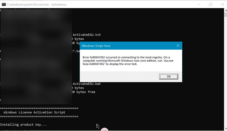

  3. Anthony Fajardo 0 Reputation points
    2025-10-20T18:58:23.75+00:00
    Anthony M,
    This is the error that necessitated the script file:
    Please ensure of this - otherwise it could explain the problem you're having:
    Current Edition : Professional Current Build : 19045.5011
    That’s the edition your ESU key must match.
