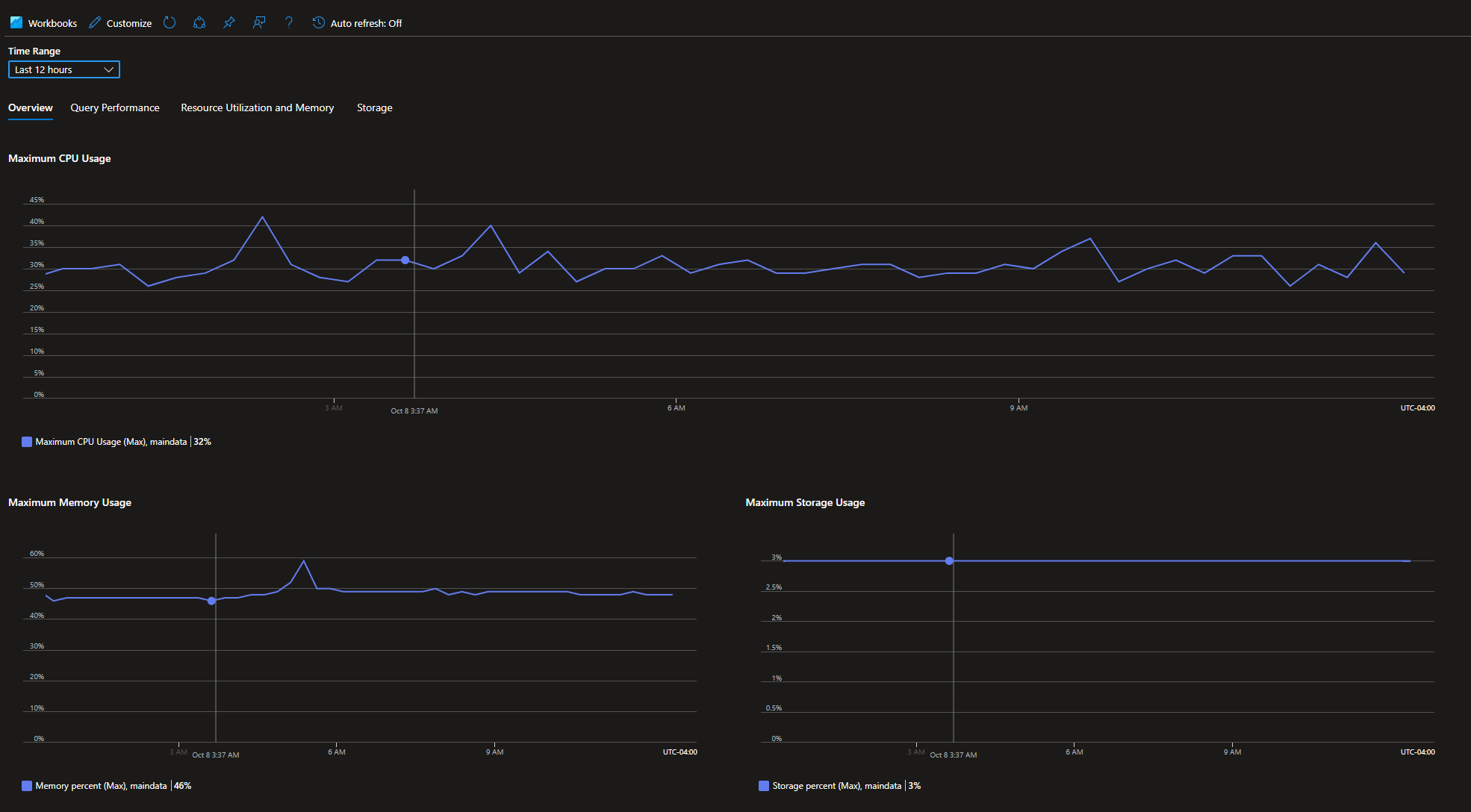

I have an Azure Cosmos DB for MongoDB (vCore) with M20 tier, 2 vCores, 4 GiB RAM. It works fine previously, and I didn't change any settings after creation. Just started from yesterday, I keep failing to connect to the database with timeouts. I checked the metrics and all the CPU, memory, storage usages look fine and stable.

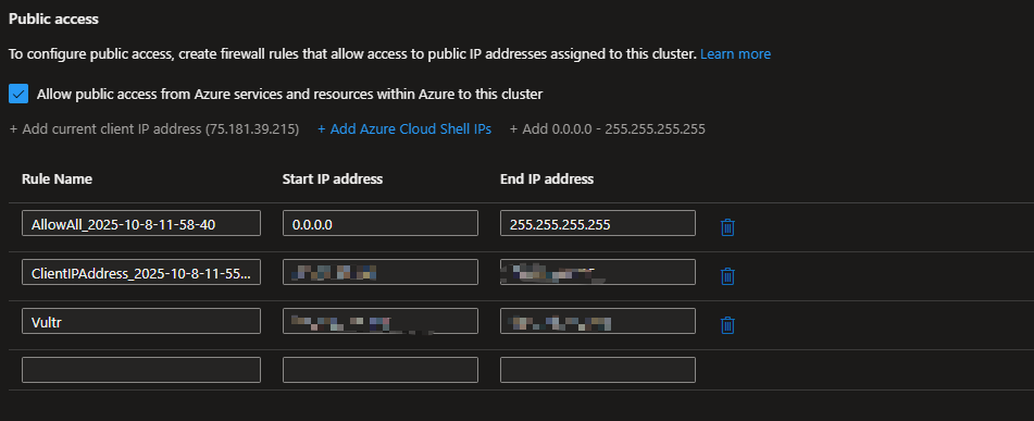

Also, I'm pretty sure it's not the network policy because I opened 0.0.0.0-255.255.255.255 since creation and it works fine previously. I didn't change any policies before the issue happened.

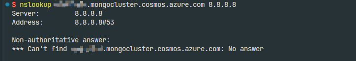

    5. check dns
      • nslookup → expect public ip (public) or private ip (private link)
      • if using srv: nslookup -type=SRV _mongodb._tcp.
      • if you see ipv6 (AAAA) answers, disable ipv6 or force ipv4 and retry
      • flush dns cache and try again
