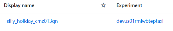

Now, we are trying to do the same in ADF pipeline for Batch Endpoints by following this guide Run batch endpoints from Azure Data Factory which leverages this api https://<endpoint_name>.<region>.inference.ml.azure.com/jobs but I cannot see which properties are available for this endpoint in this case, so my pipeline displayName are coming with default/random name which we do not want:

    https://free.blessedness.top/en-us/azure/machine-learning/reference-yaml-job-pipeline?view=azureml-api-2#yaml-syntax
    In this schema if you don't provide name then a random name will be generated as you shared in the screenshot.
