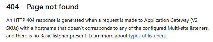

    This error usually means the gateway is unable to successfully route your request to the backend application.User's imageReference:404--page-not-found

    Next, please verify that your HTTP listener and routing rules are correctly configured. The listener should match the hostname and port you're using, and the routing rule should point to the right backend pool and HTTP settings.

    another common culprit is the listener. make sure the host name and port in your listener match exactly what you're using to test the gateway. even a small typo here will cause a 404.
