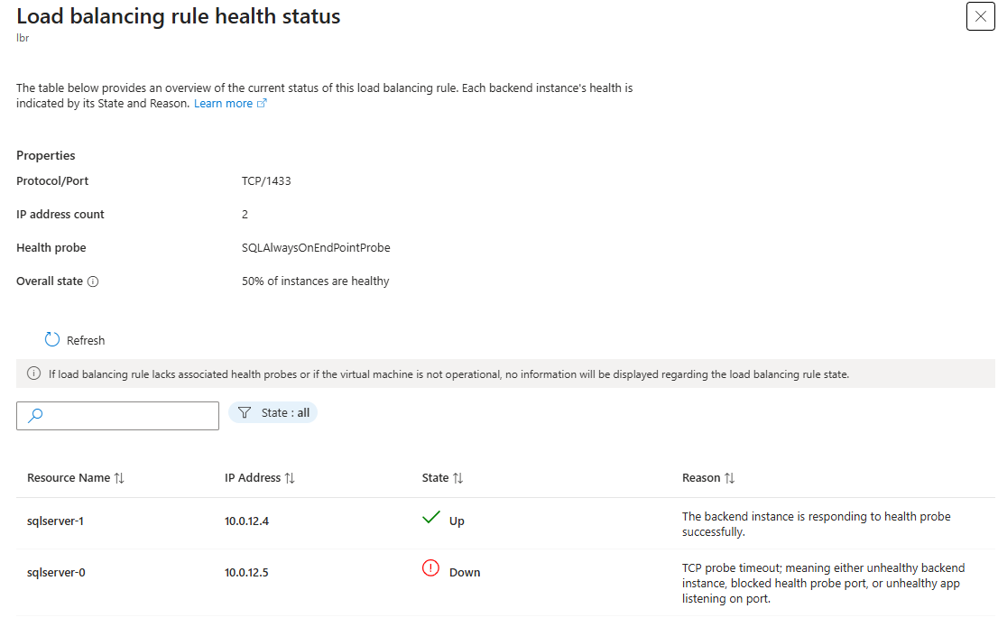

We have an Azure setup with a SQL pool containing two SQL servers (SQLServer-0 and SQLServer-1) behind a Load Balancer. The Load Balancer is configured with a custom TCP health probe on port 59999.
Everything was working as expected prior to upgrading the Load Balancer from Basic SKU to Standard SKU. After the SKU upgrade and IP change, one of the backend SQL servers (SQLServer-0) consistently reports as unhealthy, while the other (SQLServer-1) remains healthy.The servers are in the same subnet and have identical NSG, firewall, and health probe configurations.
Validated that no internal app or process is listening on 59999 on the affected server.
Noticed the same behavior in other customer environments after similar SKU upgrades, always one server in the pool appears unhealthy.
Troubleshooting Taken:
  1. Verified NSG and OS firewall rules, both servers are configured identically.
  2. On the unhealthy SQL VM (SQLServer-0), port 59999 is not in a listening state.
  3. Checked for port conflicts or usage, nothing is bound to port 59999.
  4. Telnet tests between servers:
    • From SQLServer-1 → SQLServer-0 (port 59999) -- Fails
    • From SQLServer-0 → SQLServer-1 (port 59999) -- Succeed
Could this be a known issue or bug related to Standard SKU Load Balancer behavior, especially regarding probe source IP or firewall behavior?
Are there any known issues with probe traffic routing or port binding after SKU migration?
We would appreciate any insights or recommended steps to resolve this issue, as it's now impacting multiple SQL load-balanced deployments.

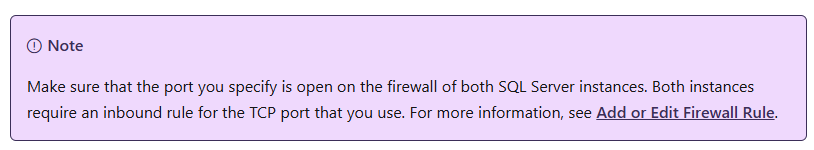

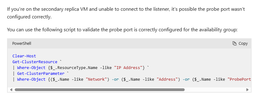

    I think the issue is related to the SQL AVG, if the port is not up and running it will cause the probe to fail and state will be down - Please check the troubleshooting steps for this - https://free.blessedness.top/en-us/troubleshoot/sql/database-engine/availability-groups/troubleshooting-availability-group-failover
