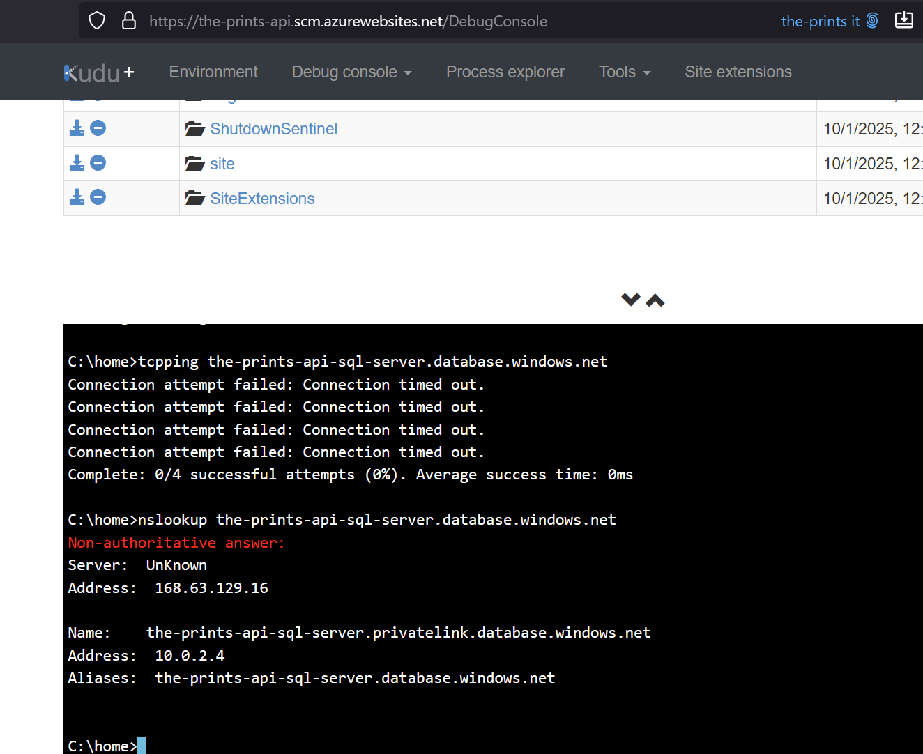

We have an Azure App Service that is unable to connect to an Azure SQL Database. The following configuration steps have already been completed, but the issue persists:

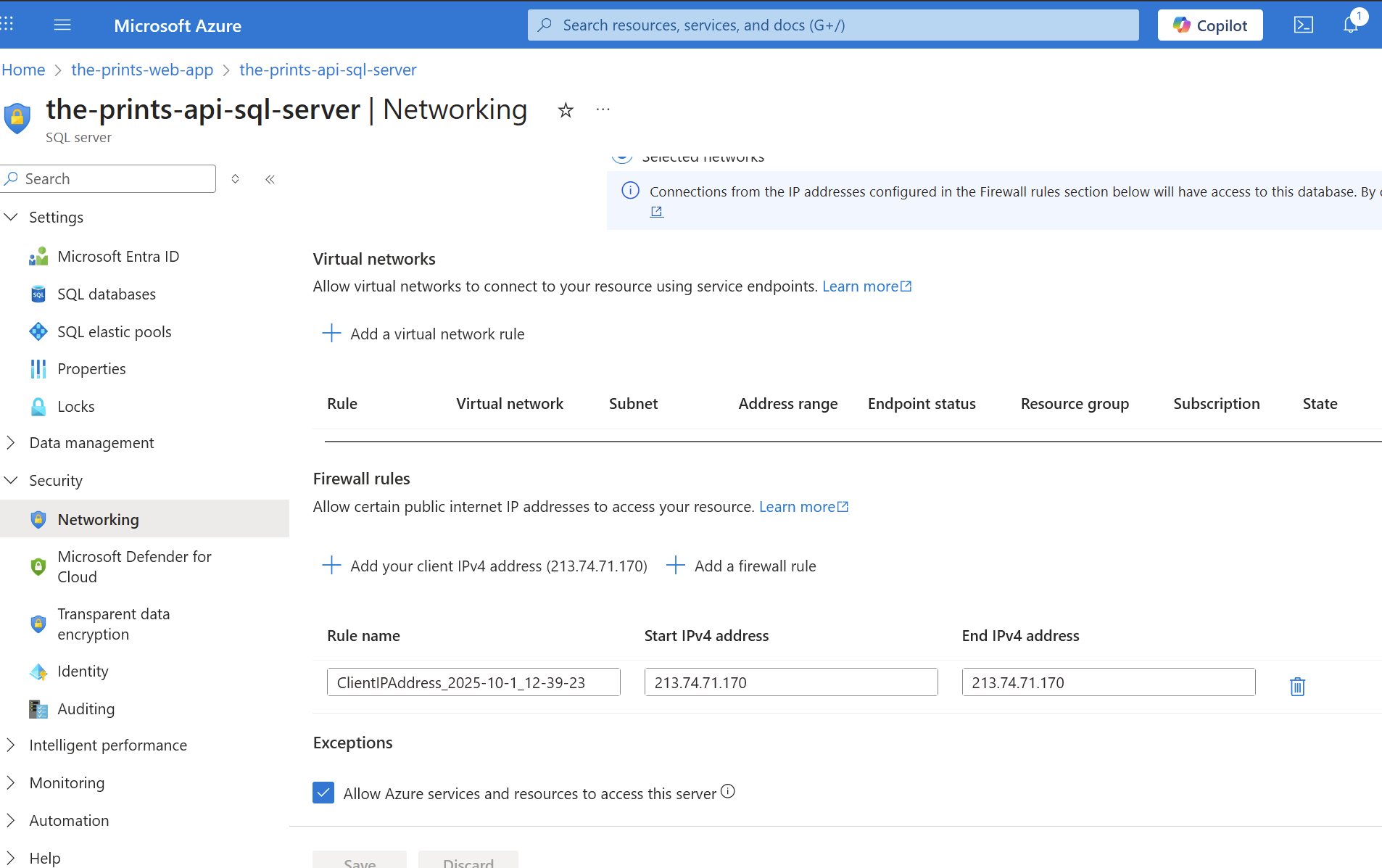

All App Service outbound IPs are added to the SQL Server Firewall and Virtual Networks rules.
“Allow Azure services and resources to access this server” is enabled.
Virtual networks are configured and integrated with the App Service.
The connection string in the App Service is correct and follows Azure SQL guidelines.
Despite these configurations, the App Service still fails to connect to the SQL Database.
Request: Could you please help identify why the App Service cannot establish a connection and confirm if there are any additional requirements (DNS, private endpoint configuration, NSG/UDR rules, or service endpoint settings) that may be preventing connectivity?
Please also advise how we can best verify which IP/DNS path the App Service is using when attempting to connect to the SQL server.

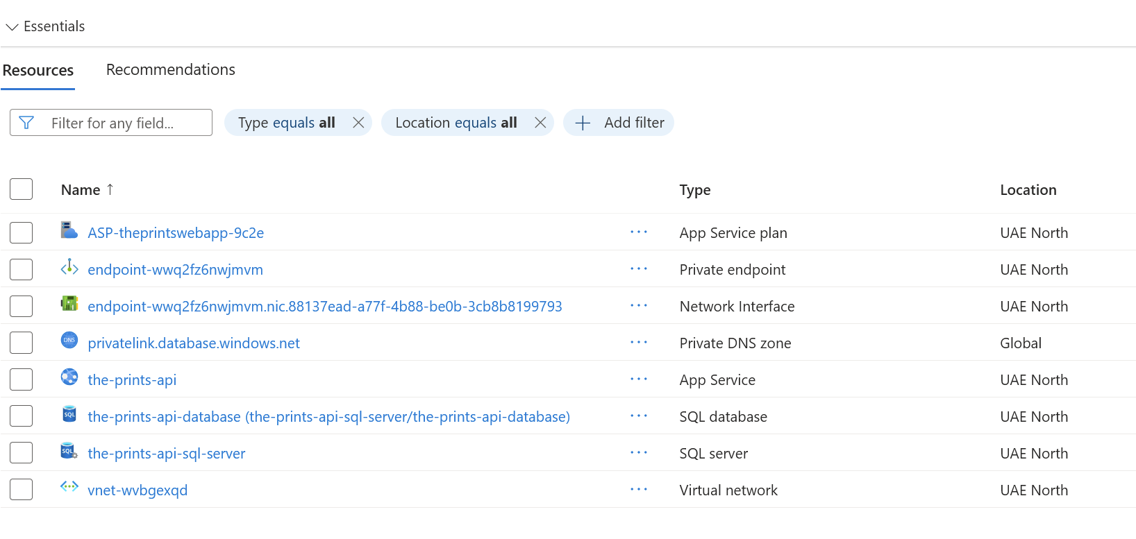

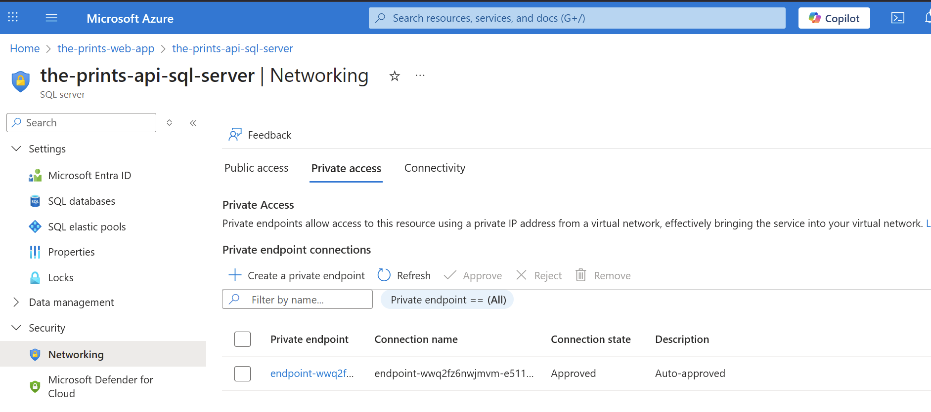

    Private Endpoint and DNS Resolution If your Azure SQL Database is configured with a private endpoint, the App Service must resolve the SQL server's fully qualified domain name (FQDN) to the private IP address of that endpoint, not the public IP. This requires proper configuration of Azure Private DNS zones (privatelink.database.windows.net) and ensuring the App Service's VNet integration supports DNS resolution to that private zone. Without correct DNS setup, the App Service will attempt to connect via the public IP and may fail.

    Service Endpoints and VNet Rules IP firewall rules allowing all App Service outbound IPs only work if the SQL Server network access settings include public network access. If VNet service endpoints or private endpoints are configured, IP firewall rules might be bypassed. Service endpoints require the subnet to have the SQL service endpoint enabled and added to the SQL Server’s VNet rules.

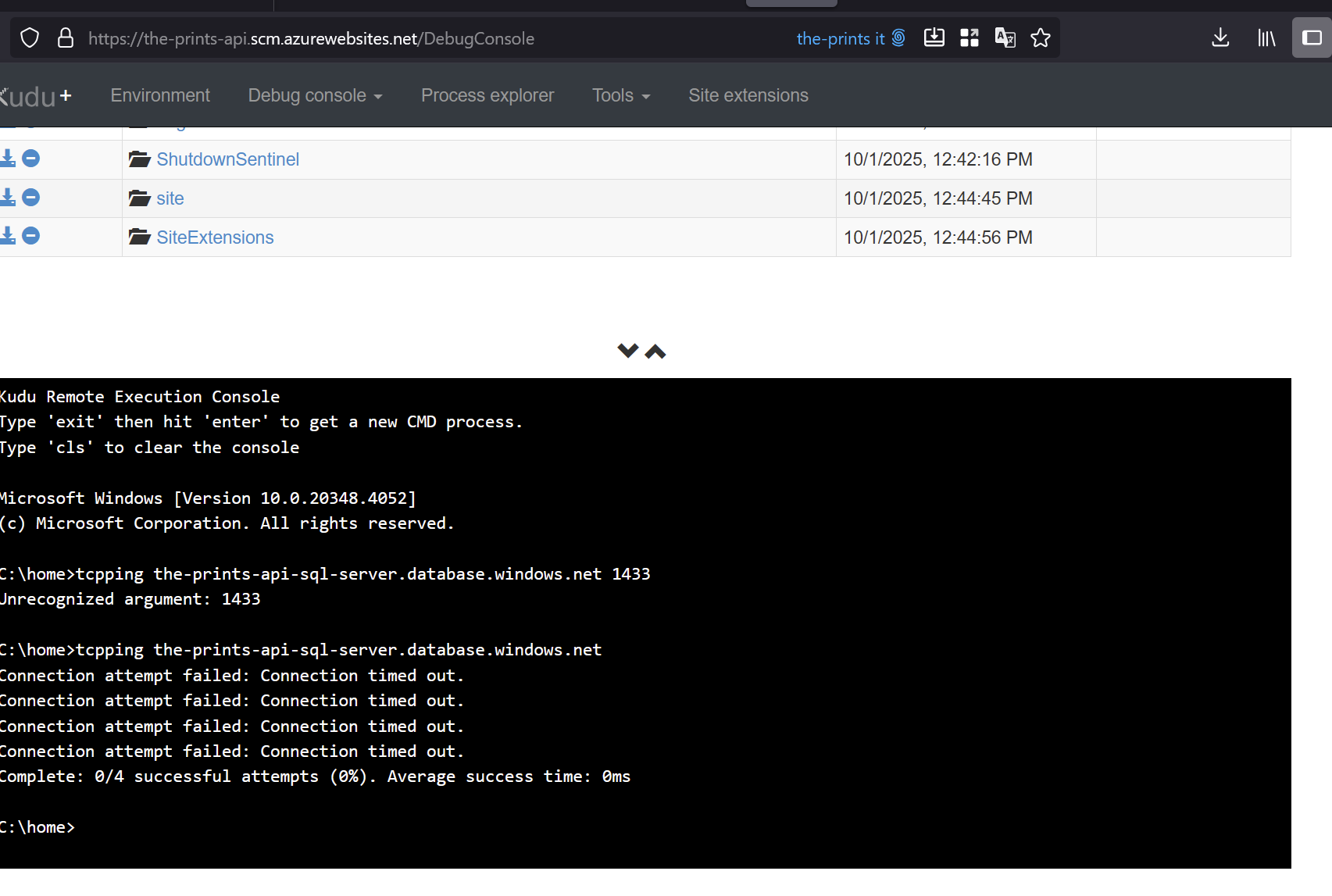

    Verification of IP and DNS used by App Service Use the Kudu Console available at https://<your-app-service-name>.scm.azurewebsites.net/DebugConsole to run commands like nslookup <sql-server-name> to check if DNS resolves to expected private or public IP. Also, application logs and Azure SQL diagnostic logging can help confirm connection attempts and source IP.
