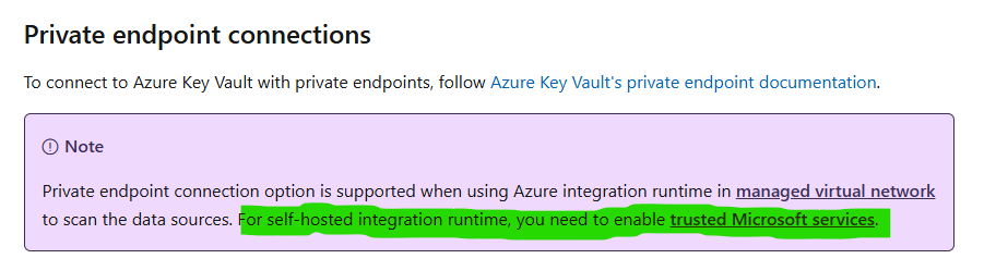

    I have configured all the 4 steps which you have mentioned , but still I was not able to access. I was using Private end points to access all services, including Purview, Key vault etc.
    Finally I figured out the issue, since I was using SHIR for scanning, we need to enable "Trusted Microsoft Services option from Key vault networking , if we disable the public access, whihc resolved the issue
    https://free.blessedness.top/en-us/purview/data-map-data-scan-credentials
    So I have a query as well, since we are using Palo Alto Firewall , may I know , is there any option to allow traffic via palo alto , rather than enabling this option ?
