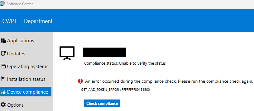

When checking Device Compliance in Software Center we are seeing the message:-
"An error occurred during the compliance check. Please run the compliance check again.
GET_AAD_TOKEN_ERROR : FFFFFFFF80131500"
Removing and reinstalling the SCCM Client and the error still occurs.

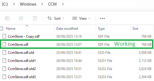

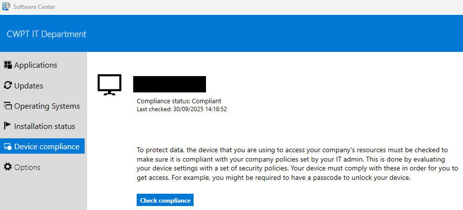

The only way we have found to "temporarily" remove this is to stop the SMS Host Service, rename the C:\Windows\CCM\CCMStore.sdf, restart the SMS Host Service and then the compliance reports okay. Typically a day later and the error occurs again though. The CCMStore.sdf is between 2MB and 3MB when the error occurs.
Has anyone got any solutions how to permanently fix this or suggestions on what might be causing the CCMStore.sdf file to cause this problem?
