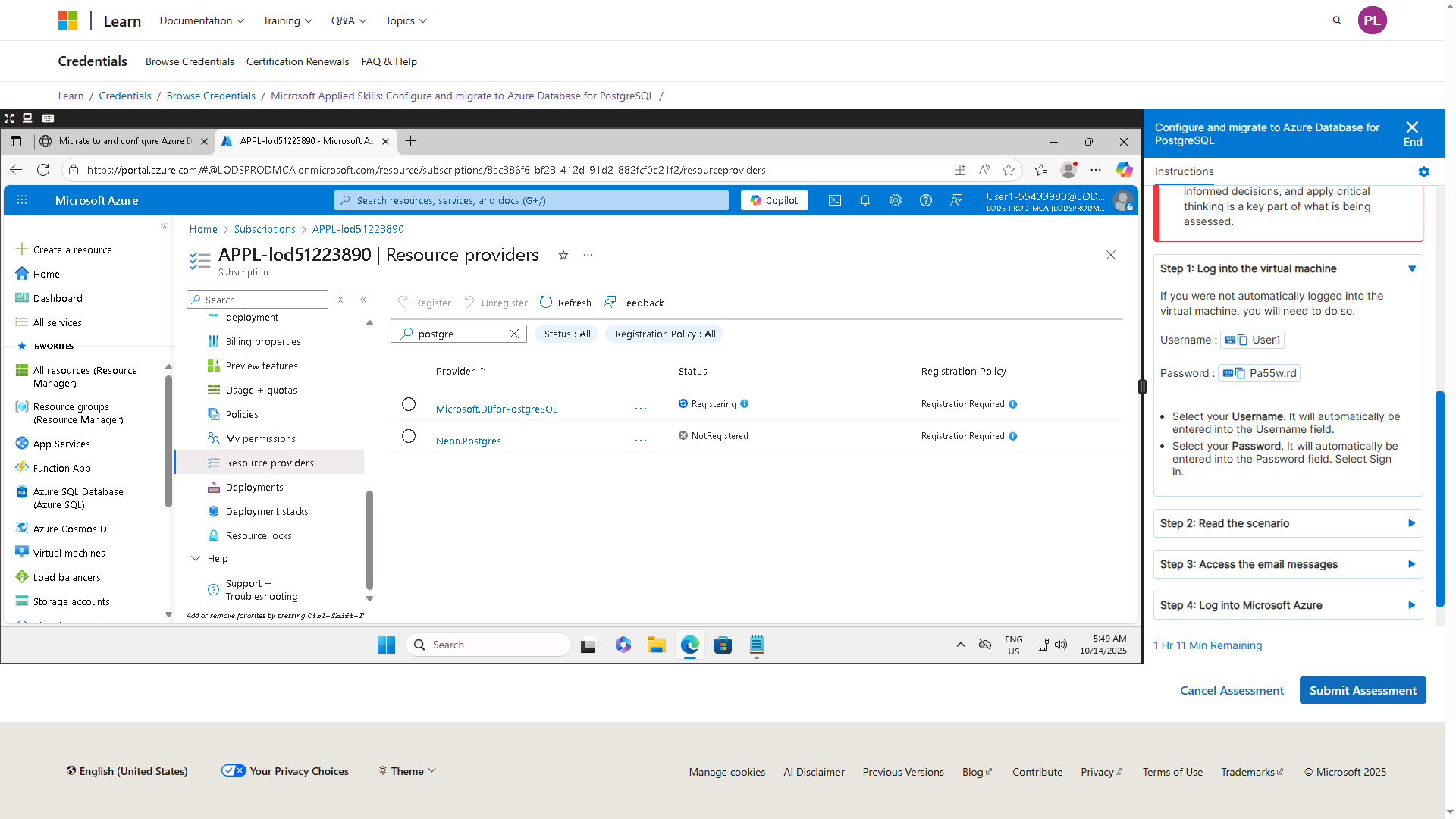

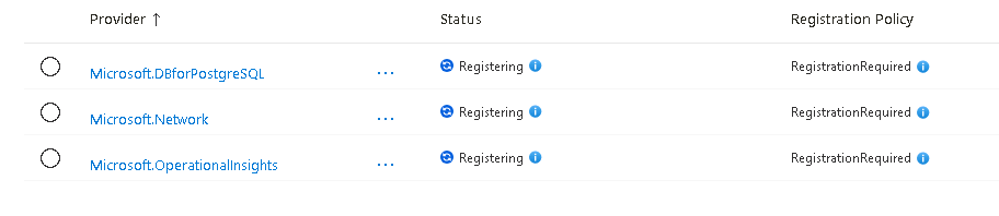

I just tried to take the 'Microsoft Applied Skills: Configure and migrate to Azure Database for PostgreSQL' assessment and failed. The first step in the assessment is to create an Azure PostgreSQL Flexible Server - I couldn't complete this task because the supplied credentials I was given to use did not have sufficient permissions to register the Resource Provider (Microsoft.DBforPostgreSQL) so I could not proceed beyond this point.
I waited a few minutes and tried to re-register the resource provider but no go.
Please fix this Microsoft.
Thanks

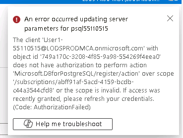

I have the same problem. I followed the condition, stayed in the same resource group RG1 as per instruction.
Also did you manage to login to the local postgres server? I found the database name but not the login info...

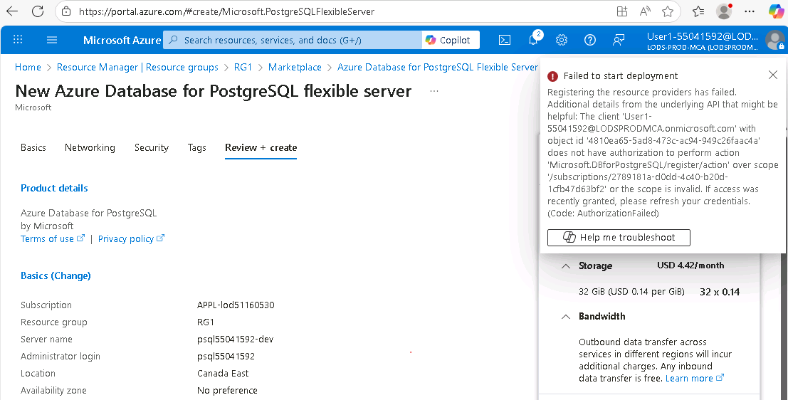

Paul Lynch • 16 Reputation points
2025-10-01T18:18:11.4233333+00:00 No, I gave up when the PostgreSQL Database deployment failed. I didn't see any point in continuing after that point.

What you’re hitting is a permission boundary in the Applied Skills sandbox. The lab subscription gives you Contributor on a temporary subscription, but registering a resource provider (Microsoft.DBforPostgreSQL) requires Owner or a subscription-level role you don’t get in the sandbox. That’s whyRegisterkeeps failing and you can’t proceed with creating a Flexible Server.Quick things to try (sometimes fixes a mis-provisioned sandbox):
End the sandbox and start a fresh one (wait ~2–3 minutes before re-starting).
After it comes up, run (read-only) to confirm state:
az account show --query id -o tsvaz provider show -n Microsoft.DBforPostgreSQL --query "registrationState"If it isn’t “Registered”, you won’t be able to proceed. If a fresh sandbox still isn’t pre-registered, that’s on the lab setup and needs a fix. in this case, please provide required details in private message. -

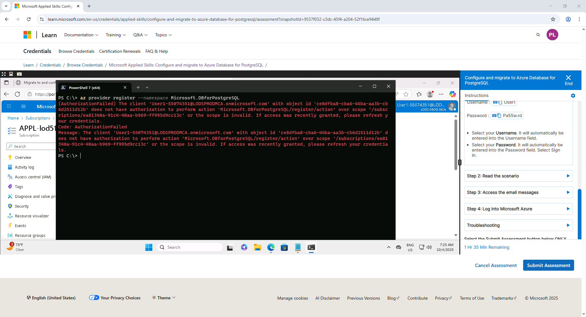

2025-10-04T14:36:59.87+00:00 Hi,
I tried to re-register the resource provider but it is still failing. The problem with your advice to end the sandbox is that you have to wait 72 hours to try again. That's not really a viable solution I'm afraid.

2025-10-11T12:52:11.0966667+00:00 I just tried the assessment again and it is still failing for the same reason.

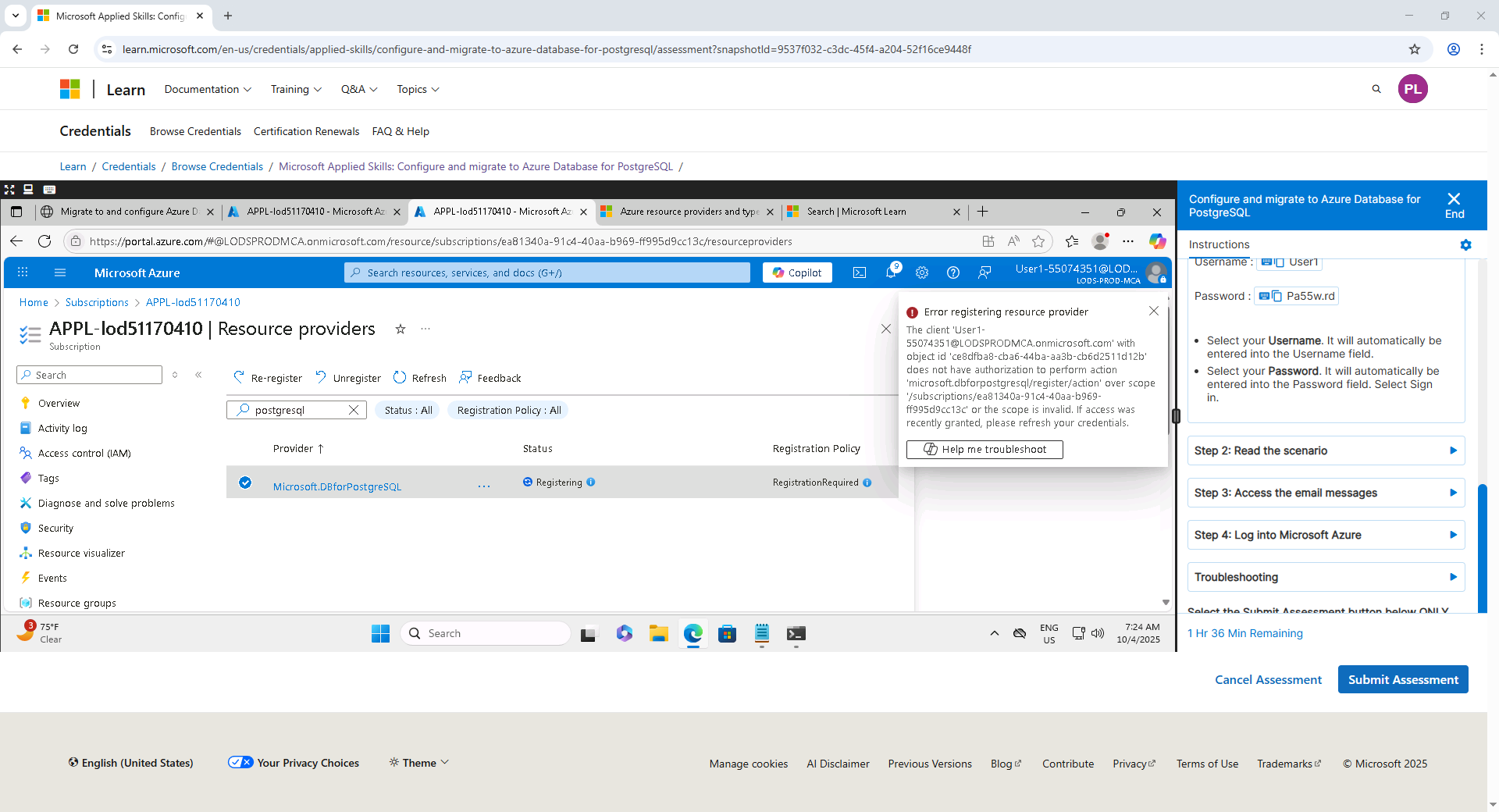

2025-10-14T12:54:04.16+00:00 Tried again - quit after waiting over 50 minutes for the Resource Provider to finish registering. This Applied Skill lab is truly broken.

Thanks for all the screenshots and for sticking with it.What’s happening
The Applied Skills sandbox gives you Contributor on a temporary subscription. Creating an Azure Database for PostgreSQL (Flexible Server) forces the platform to register the providerMicrosoft.DBforPostgreSQLat the subscription scope. That action needs Owner (or a custom role with*/register/action). Because the lab subscription isn’t pre-registered and you don’t have that permission, the implicit register call fails withAuthorizationFailed, exactly as your toasts show.What you can verify quickly
- In the portal: Subscription → Resource providers → search “postgres”.
Microsoft.DBforPostgreSQL(and sometimesNeon.Postgres) must show Registered. If it’s NotRegistered or stuck on Registering and pops the same error, it’s a permission boundary, not something you can fix inside the lab. - CLI check (read-only):
az provider show -n Microsoft.DBforPostgreSQL --query registrationState -o tsvAnything other thanRegisteredin this sandbox means the same issue.
