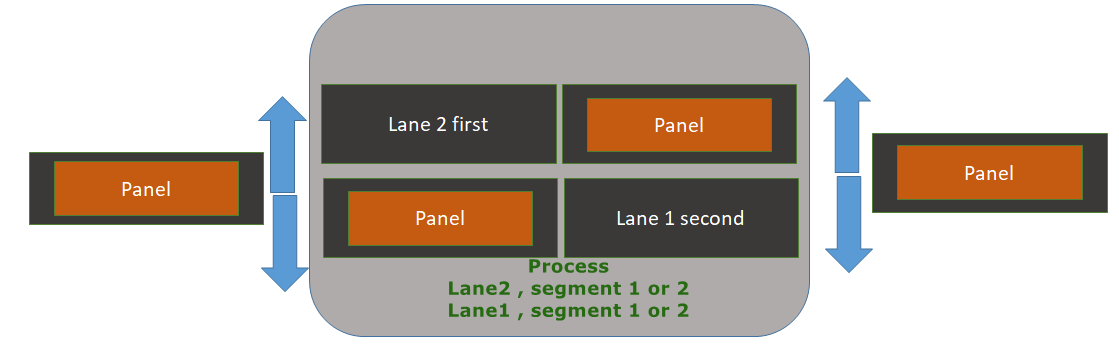

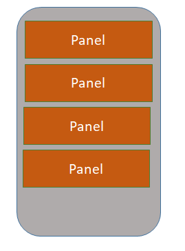

I have a process with two lanes. One input is supplied by the panel.
Sometimes lane 1 is faster, sometimes slower, this is controlled by the PLC. How can I replicate this process exactly?
Each panel must know which lane it was produced from. Do I need a std::vector? How do I recreate the lines? Matrix? Does anyone have a good concept or idea?
Panel:
  • ID
  • StartTime
  • EndTime
  • LaneNo
  • SegmentNo
Input
enter image description here
Process

    This process simulates how panels move through a two-lane manufacturing system. Each panel starts in Segment 1 of either Lane 1 or Lane 2. The PLC controls the speed of each lane, so sometimes Lane 1 is faster, sometimes Lane 2. Panels are processed in FIFO order. first, they move from Segment 1 to Segment 2, and once Segment 2 is complete, they’re marked as finished. Each panel keeps track of its lane, segment, start time, and end time throughout the process.
