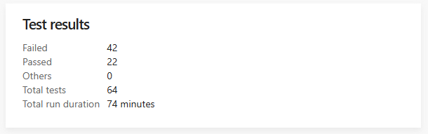

I'm running automation testcases in azure pipeline using yaml. I've used Cypress automation tool and automated salesforce. After the completion of running the pipeline, i'm getting a email on the test results as follows:
I wanted the test results to be bit more detailed. Instead of total passed/failed, I want the email to have which testcases got passed/failed. Is there a way to achieve it.
