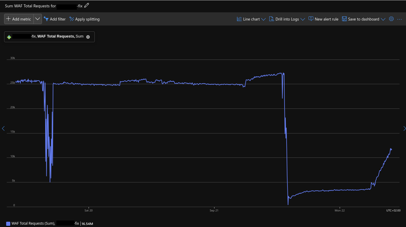

We are very often experiencing crashes/performance degradation of our Application Gateway with associated WAF in detection mode. Throughput on the AGW is just about 100 req/s and it doesn't change much throughout the day (IoT devices requests, all across EU).
If we dissociate WAF from the AGW, it works without any issues. But once the WAF is added (detection mode, owasp rules, bot detection), we get these issues.

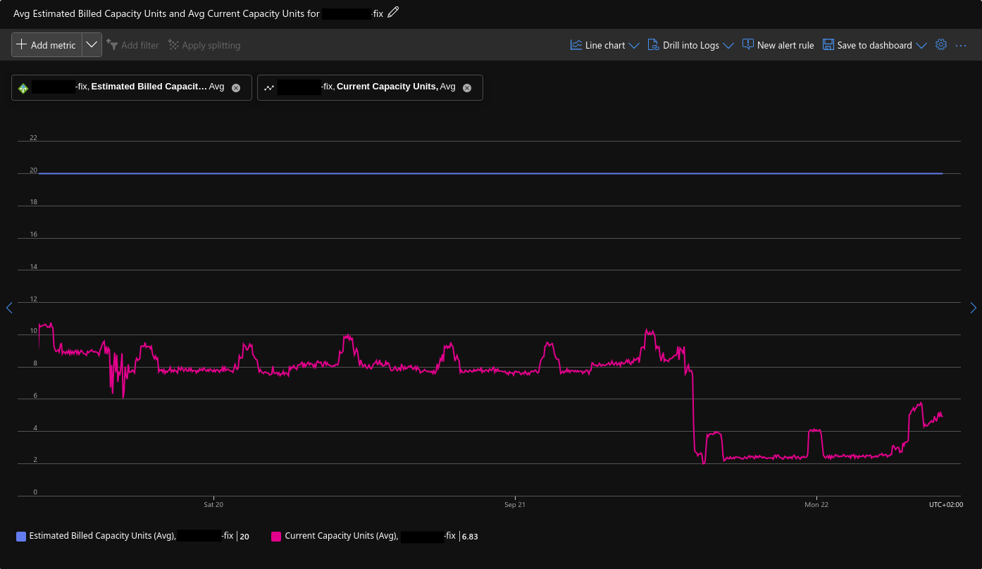

We tried different configurations of the AGW but nothing seems to help. We tried:
  1. manual scale of 2 instances
  2. autoscaling from 0 to 4 instances
  3. autoscaling from 2 to 4 instances
What can we do to fix resilience/availability of the AGW with WAF?
WAF requests
waf total requests, 5 min interval
Estimated billing vs Used compute units
compute units, 5 min interval

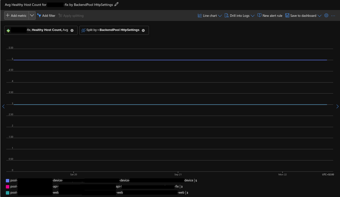

Health backends
healthy_bcknd

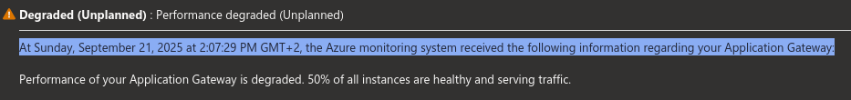

Resource health alerts
We get these alerts once or twice a week. But there are some performance issues pretty much every day.
