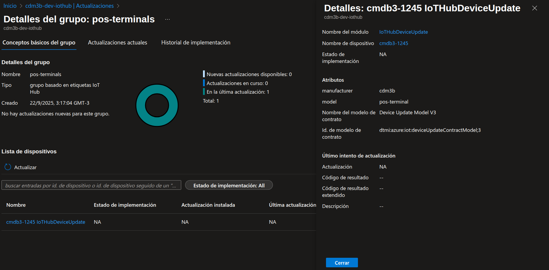

In my first try i get the deploy to work with a test device. I deletes the device, i delete the import, create a new device, install the device update agent, conected and try again and now for my surprise i cant create a deploy, for some reason the DU consider that my device is not compatible and i dont understand why.

i keep looping through this files to check what could we wrong, but i just not find a clue of the problem.
