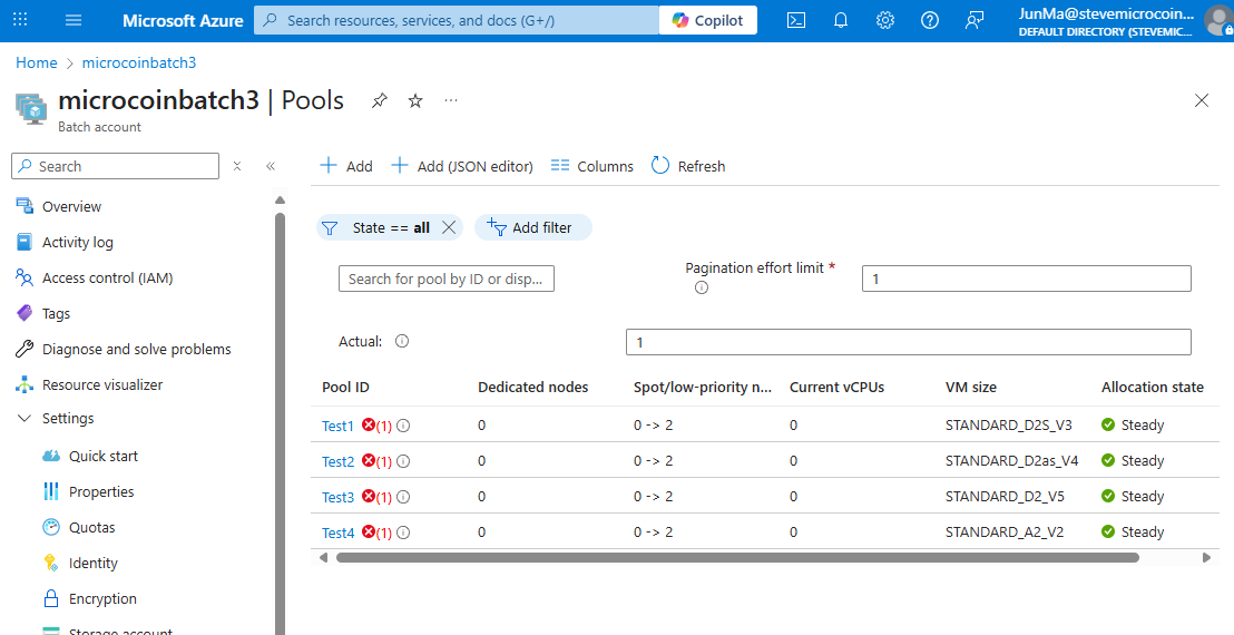

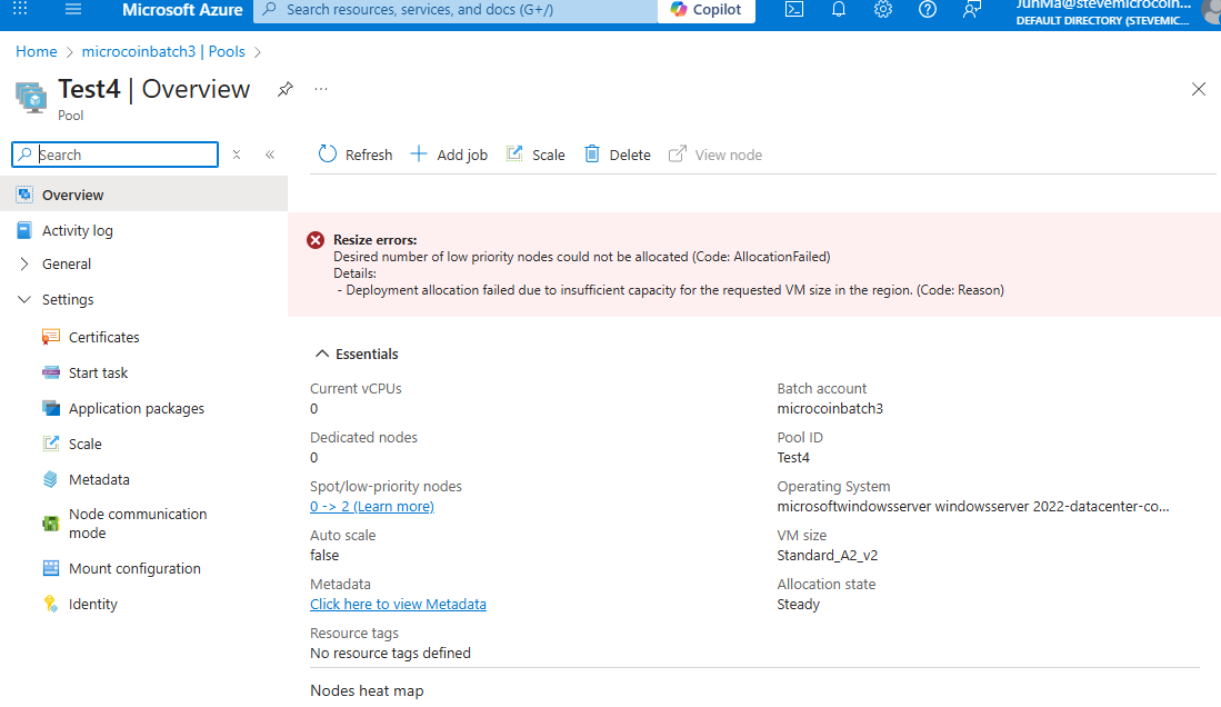

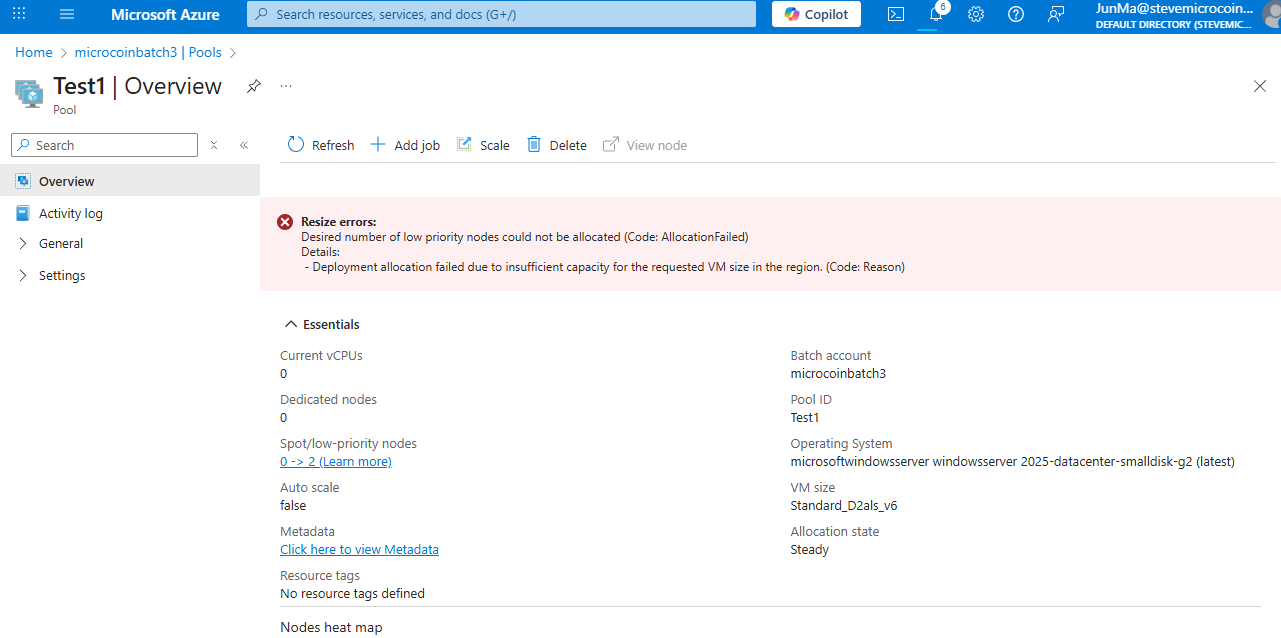

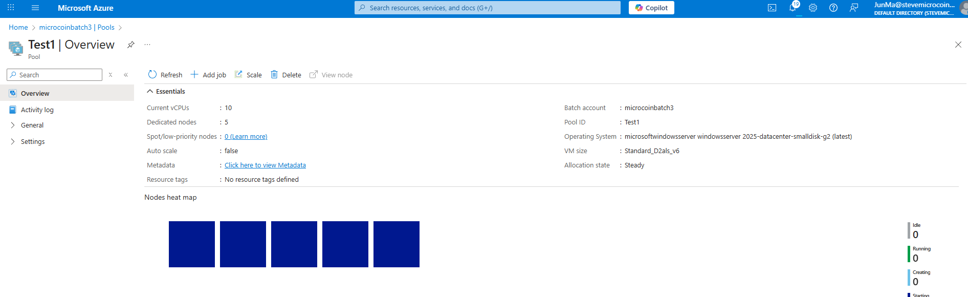

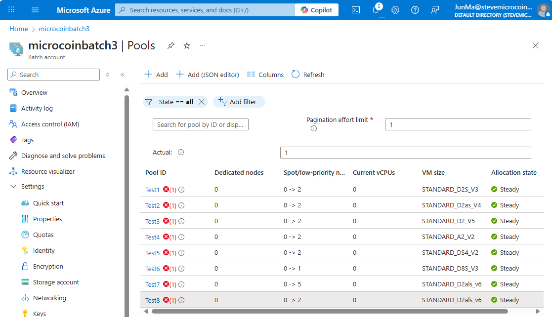

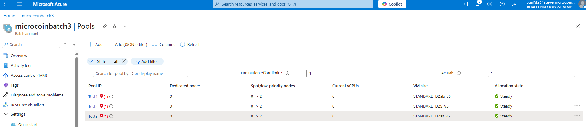

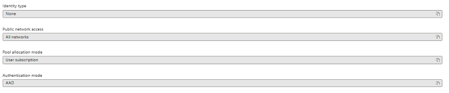

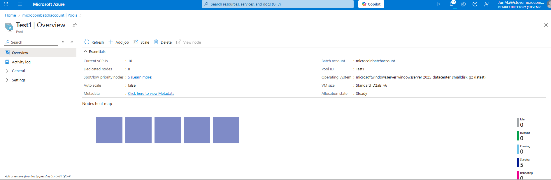

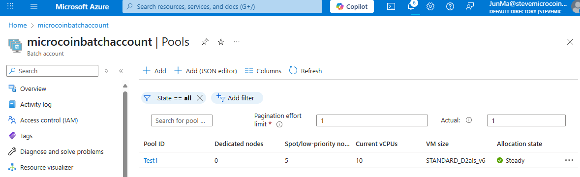

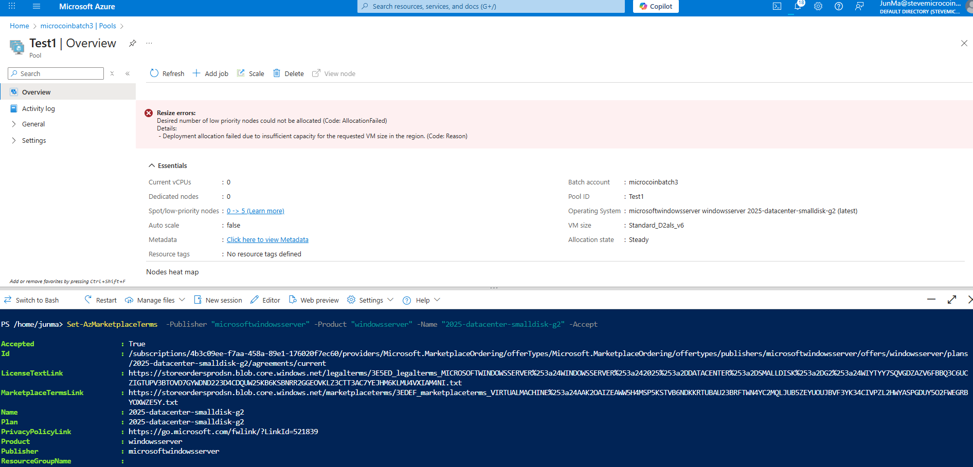

I can not create a batch pool with spot virtual machines. I used UserSubscription for poolAllocationMode. I tried Australia East, Australia Central, UK South and different VMSizes. Dedicated node works but Spot/low-priority nodes do not work. Always get the following error.
Resize errors: Desired number of low priority nodes could not be allocated Code: AllocationFailed Details:
  • Deployment allocation failed due to insufficient capacity for the requested VM size in the region. Code: Reason

    Thank you for your patience while we investigated this issue.

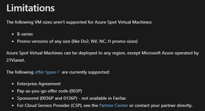

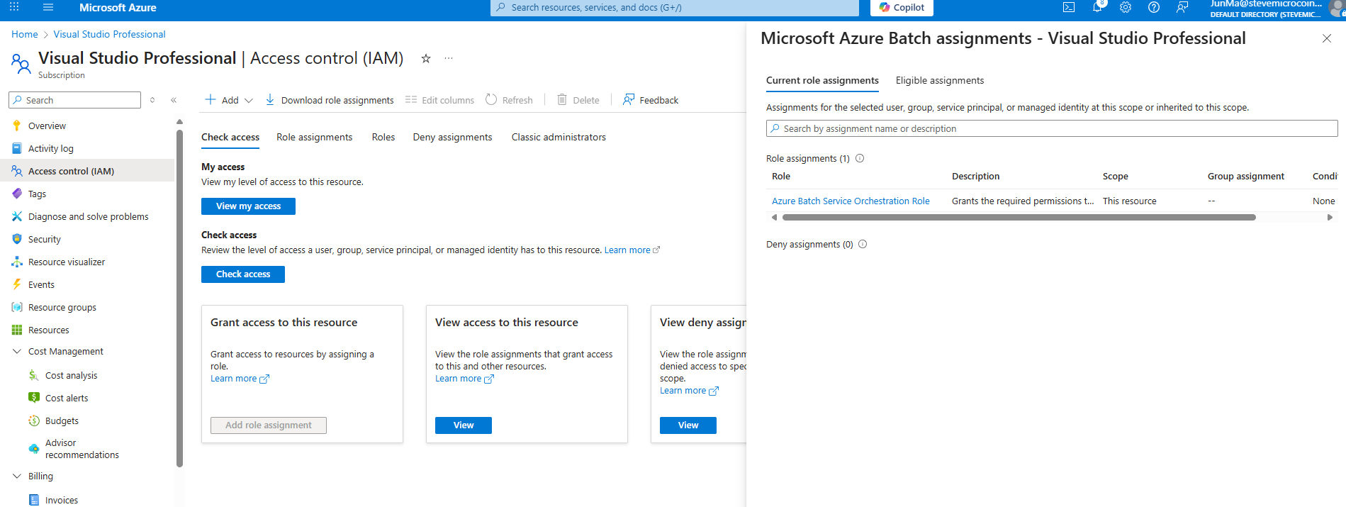

    We performed all the standard mitigation steps on our end, including validating the configuration, assigning the required roles, and confirming your Batch and VM setup. After completing these checks, we verified from the backend that the error is not related to permissions or configuration but is instead due to a subscription limitation.
    Your current subscription type (Visual Studio Professional Credit | Microsoft Azure) is not eligible for deploying Spot Virtual Machines. This is a known limitation with certain subscription offers such as Visual Studio/MSDN monthly credit subscriptions.
    To use Spot VMs, you will need to create or switch to a subscription type that supports them, such as:
    please refer below documentation:
    https://free.blessedness.top/en-us/azure/virtual-machines/spot-vms#limitations
    https://azure.microsoft.com/en-us/pricing/offers/ms-azr-0059p/

    Thanks for sharing your issue in the Q&A. Based on the details, the allocation failure you’re experiencing when creating a Spot VM pool happens due to insufficient available capacity in the selected region for the requested VM size.
    Since Spot VMs rely on unused Azure capacity, their availability isn’t guaranteed and can fluctuate based on regional demand. Regions such as Australia East, Australia Central, and UK South often have limited Spot availability.
    Additionally, keep in mind that not all VM sizes support Spot pricing. Choosing an unsupported VM size will also result in allocation failures.

    Notes for User Subscription Mode:

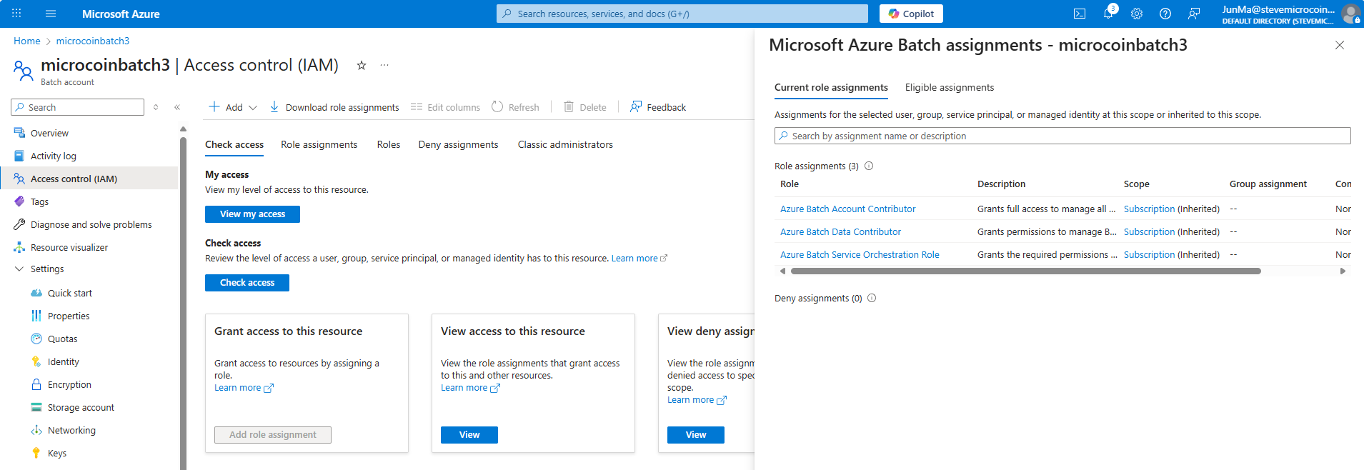

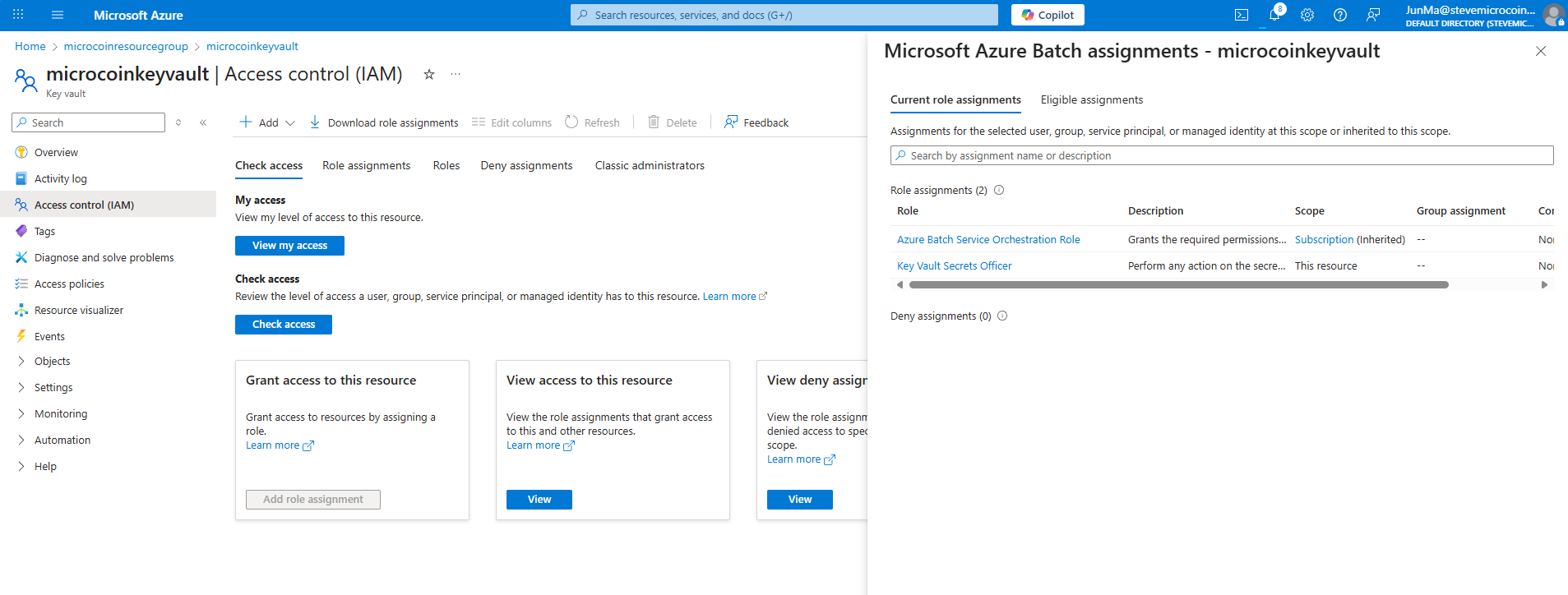

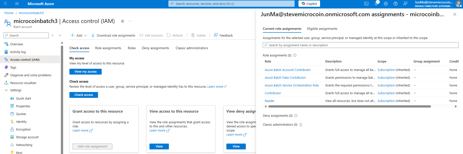

    If you are using User subscription mode with Azure Batch (instead of Batch service mode), additional configuration is needed because the Batch service manages resources directly in your subscription:
    • Ensure the Batch service has Contributor or Owner role on your subscription.
    • Accept the legal terms for any marketplace VM images you plan to use.
    • Assign the Azure Batch Service Orchestration Role to the Batch service principal.
    If these prerequisites are not configured, pool resizing or VM allocation may fail.
