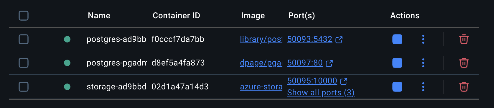

I have docker desktop running on Mac M1, and trying to connect to it from Visual Studio in Windows 11 inside Parallels. I am able to browse apps running in Docker from edge in windows with no issues.

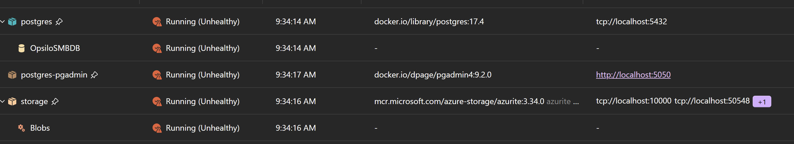

Aspire app out project is able to run the docker containers, however, it is connecting to them using the localhost connection string. I want to force Aspire to use "host" instead of "localhost".
any idea?

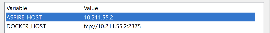

    1.Check Environment Variables: You can try setting the ASPIRE_HOST environment variable in your Windows environment to the appropriate host IP address. Sometimes, using host.docker.internal can help bridge the network between Docker containers and the host machine.

    Aspire is still defaulting to localhost. Here's how to force it to use the correct host:
    1. Verify Aspire Configuration
    Ensure Aspire is actually reading the ASPIRE_HOST environment variable. You might need to:
    • Set it in the Visual Studio launch settings (launchSettings.json).
    • Or set it globally in Windows Environment Variables and restart Visual Studio.

    1. Check Docker Health Probes
    The "unhealthy" status might be due to missing or misconfigured health checks in your Dockerfiles or Compose setup. Add proper HEALTHCHECK instructions if needed.
