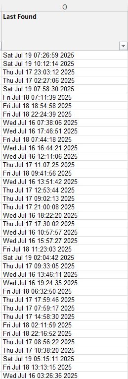

The format of the values in excel file are:
Screenshot 2025-09-09 180053 My derived column expression is
(DT_DBDATE)[Last Found]
And I am getting an error message:

    hi @Ali Ahad,
    Please try the following solution based on tokenization.
    1. Assuming that data is in the following consistent format: Sat Jul 19 07:58:30 2025
    2. Make sure that SSIS column, let's say [excel_date], is of DT_WSTR data type.
    3. Use Derived Column SSIS Task with the following expression:
    TOKEN([excel_date] ," ",5) + "-" + TOKEN([excel_date] ," ",2) + "-" + TOKEN([excel_date] ," ",3)
    As end result it will be formatted as '2025-Jul-19', and after insertion into a database table column [LAST_FOUND] of DATE type it will hold 2025-07-19 value.

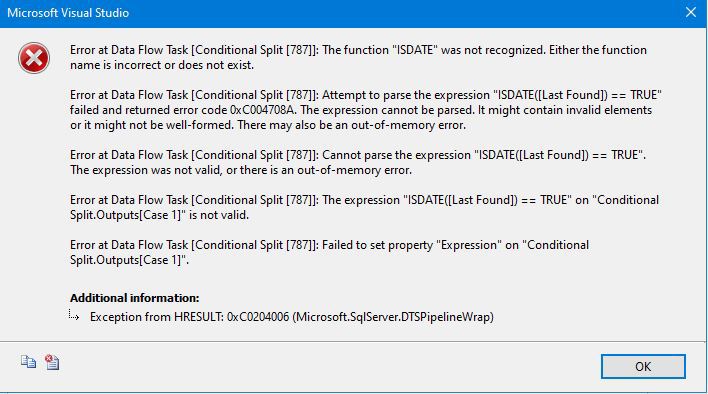

    Thanks for explaining this in detail. I am trying to do the Conditional Split but I am getting an error message that 'ISDATE' function is not recognized.
    ISDATE_Error
    I am not able to find the any other function to check for the date.
