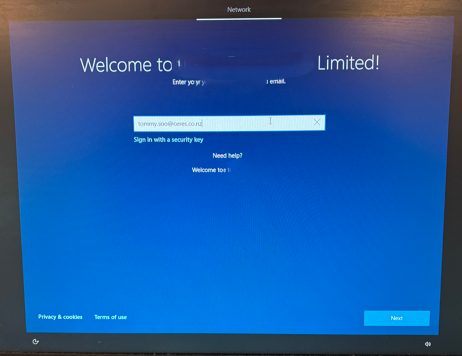

Just a bit of a background, I am in a hybrid environment and our machines are prepped via MDT
I'd like to know whether is it possible to configure these already existing devices to Autopilot. I have followed multiple tutorials online to configure Autopilot in our Intune Admin Center, nothing fancy just the basics in order to see how it works with our current setup
I am testing via a VM with the following configs
  1. Re-imaged VM via MDT
  2. AAD hybrid joined and Intune enrolled
  3. HWID imported into Autopilot
  4. Ensure that the machine is enabled for Autopilot
I know that Autopilot Reset is not an available option as it isn't support in a hybrid environment, I have tried using Fresh Start and Wipe but both have failed. I got the standard "There was a problem resetting your PC. No changes were made" error
A bit puzzled as to where i got wrong or why the reset isn't moving forward
Essentially what I'd like to achieve is the following
  1. Enroll existing MDT devices into Autopilot
  2. When needed I'd like to wipe the device via Autopilot and re-issue the device to a new user as opposed to re-imaging via MDT
